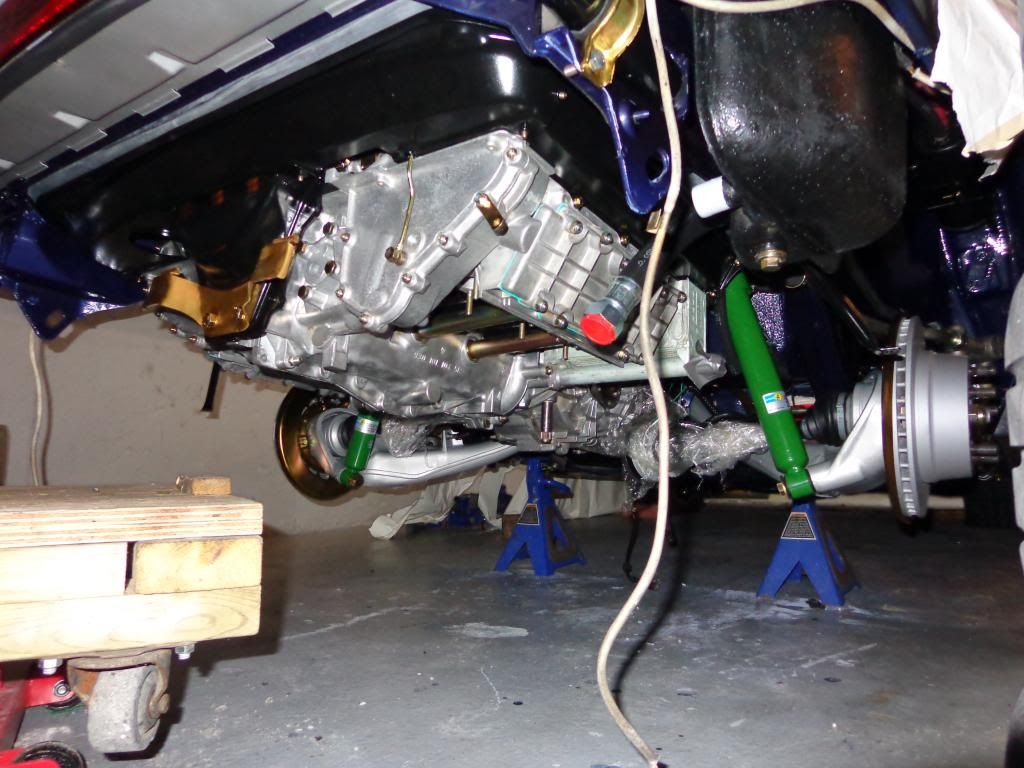

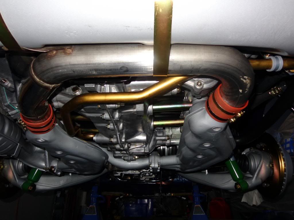

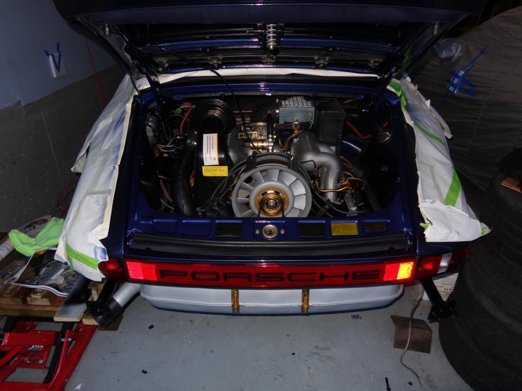

I started my rebuilt 3.2 Carrera up for the first time last night, for its maiden 20 minute run. I was nervous as it was my first motor rebuild and although I tried hard to be ultra-careful, I was fearful of missing something.
Fortunately, all appears well. The motor ran very smooth, with good oil pressure and no leaks or seepage anywhere.
This was a complete rebuild. I used new Mahle Euro P’s & C’s but went with a 0.5 mm thick cylinder base gasket to wind up with a calculated CR of 10.0:1. Other than that, no performance modifications were made. Everything was focused towards making a maximum longevity engine. To that end I used ARP rod bolts and Supertec head studs.
I owe a lot of thanks to people on this forum. Although I did not post much, I learned a ton by searching and reading countless threads. So, a collective “Thank you” to the combined brain trust here.
Henry Schmidt was particularly helpful, answering questions for me off line. I went with Henry’s case sealing method and it certainly seems to be perfect.
Here is a video of the startup:
1985 Porsche 911 Carrera first startup after rebuild - YouTube
Some pics:

Thank you everyone for the very nice comments.
I can't understate how much I have relied on the wisdom shared by experts.
Today I started it up once more, as I did not drain the oil from right after the first run and I wanted to warm the oil to help it drain. This time it started instantly and sounded really good again. No real smoke or anything untoward.
After start up, it idles at 1200 rpm intially, with a steady 3.5 bar of oil pressure. Once warm, the idle drops to around 800 rpm, and the pressure still reads between 3 and 3.5.
When I drained the oil it looked good. I used Brad Penn break-in oil and I think I could see some of the lithium from the assembly lube. I passed the oil through a paint strainer and there was nothing I could see yet.
I filled in new oil and now I have a couple of weeks of work to finish off things like doing a wheel alignment etc. and then I will be able to take it out for its first real break-in run.

Well, the break in process is just starting! I'm following Wayne Dempsey's, in which he does the intial 20 minutes at 2000 rpm, dumps the oil and then does a series of drives (with new oil of couse) in which the car is loaded in acceleration (3/4 throttle to ~5000 rpm) and deceleration (coasting down a hill from speed, in gear - to load the pistons with vacuum)
Originally Posted by E Sully View Post
...Are you running a stock US chip in the DME? Just curious about how that works with the increased compression.
Yes, I am running a stock US chip. A reputable builder in these parts, Brent Hunter does that too. I am also taking his advice and using 0.5 mm cylinder base gaskets, which lowers the compression to a calculated 10.0:1, right in between US and Euro spec.
