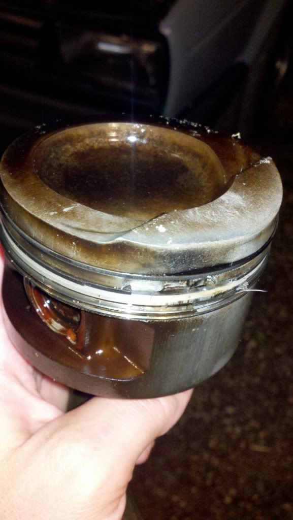

Walt, I would move forward with the LED test at the injector harness. Might be wiring between the connector and ecu for that one cyl. Not sure if you've done this test before but be sure not to use a conventional bulb as it may overload the ecu injector driver and burn it out. LED only, RadioShack will have them in 12v.
The failure happened at a really bad time; ~25lbs of manifold boost and high rpm. I felt it break up and lifted the throttle immediately and went to the clutch.
First found the spark plug broken, oil soaked and quite lucky it did not come apart and drop the bits into the cylinder to be pounded into the head. Only piston in the engine to have any damage...

Well, I can try the LED bit. I can make them up with a resistor (forget just what value, but can find it) and LED from my stashes. Or just purchase. Since it clicked, same as its neighbor, I'm not holding out much hope for something as simple as wiring. My TPS issues were a crimp connector which had somehow pulled apart - bad crimp and I guess tension while the assembly was hanging from some bungees as car sat in trailer as it moved, etc. Calls for opening up the carefully zip tied loom, but what the heck.
Is the damage to rings and lands on that cylinder due to detonation? Looks like the kind of thing which led my wife to veto my 2.16L turbo motor project - didn't want to learn by breaking. But that can follow you anywhere.
