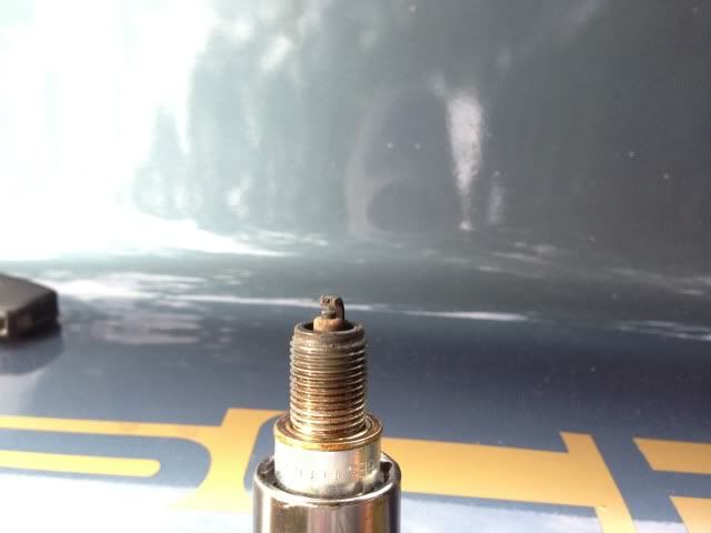

If there's an uneven puffing from the crankcase breather at idle speed or above and when blipping the throttle that may be from excessive blow by around broken compression piston ring(s) on number 6.
How does the number 6 spark plug look?

Here's a look at the #6 plug:
I'm noticing some roughness in the idle, a low spit from the exhaust every so often.

Agree that is a lot of variation. Cylinder 2 has something as well. The oil issue says rings to me, but could be valves too. Only choice to be sure is teardown the top end (including cylinders) and look at EVERYTHING. A leakdown test may help narrow suspicion prior to teardown, but if you are taking off the heads may as well take off cylinders and check those (plus a rod bearing or two). I am tho by nature one of those "check everything while in there" kind of people if it doesn't take a lot of parts that are $$$$. The idle roughness and spit may be related to this issue or just a mixture problem.
Plug looks like it is eroded a little, running hot maybe. Could be a combination of problems.

A hot running engine is typically an indication of a lean running condition and the plug appears to agree with this.
