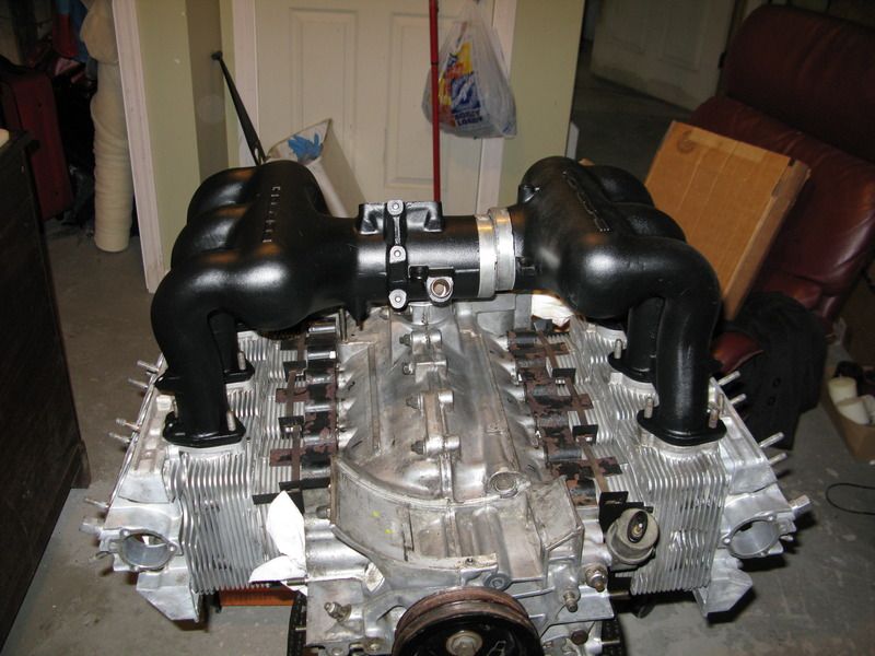

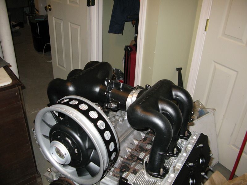

She decided on a black and silver color scheme for easy cleaning and maint. I just picked up some parts from the powder coater today and threw them onto the engine to see how it was going to look.
Manifolds PC with a textured black. You can see where she cut off some of the mounting lugs and then ground them flat and dressed some of the casting partking lines to make it look better
http://i70.photobucket.com/albums/i1...psevhlstfm.jpg

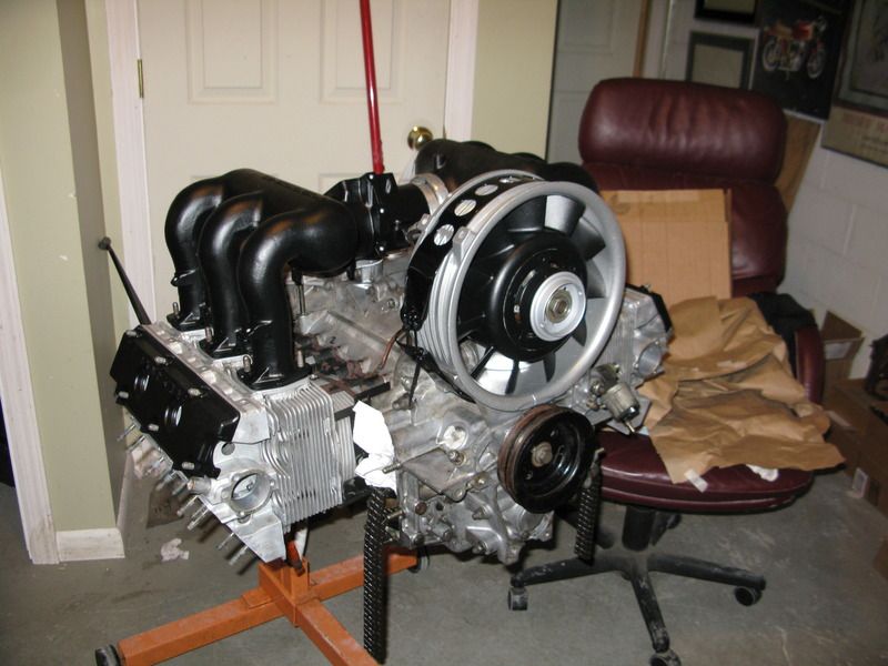

She mounted the fan strap in the mill and cut some lightening and racy looking holes into it so the silver of the fan shroud shows thru.
http://i70.photobucket.com/albums/i1...pss4hhgdxi.jpg
Upper and lower valve covers were also PC the textured black. On the manifold and valve cover the black will be sanded off the "Porsche" to make them stand out.
http://i70.photobucket.com/albums/i1...psgv1a04js.jpg
Powder Coater did a good job of matching the surface texture of the ground down areas of the aluminum to the original cast aluminum by using a heavier grit in the blast cabinet.
http://i70.photobucket.com/albums/i1...pskfgnqxf3.jpg
Overall she is very pleased with her color theme.

Cool colour combo. Pretty much exactly the opposite of mine, but yours really shows off the intake better.

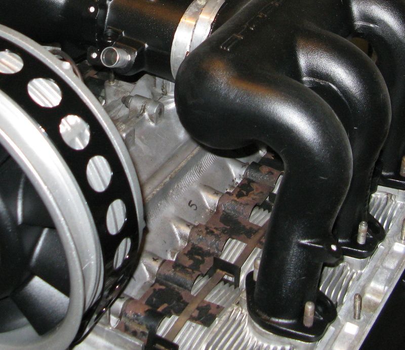

KTL 04-12-2015 06:54 AM
Agreed the black accents look really nice. I think the black fan looks great!
Did you forget to take the air guides for the cylinders to the powdercoater? That upper piece that overlays the case thru bolts is all rusty...... :confused:
Jcslocum 04-12-2015 07:52 PM
I hoped to get away with the crusty air guides. Being a cheep Yankee, out of sight out of powder coat. I may take them off and do some high temp rattle can. Then again, maybe not....

JFairman 04-12-2015 08:19 PM
This is a fun thread to look at. It's the first time I've seen a cute young girl building a Porsche motor and obviously she's really into it. Cool!
I would remove the air guides while you can and use a wire brush on a die grinder or electric drill to remove the rust from them and the spring clips. Then spray them with a can of satin black engine enamel.
Hang them with pieces of wire while spraying and drying.
They'll look nice like the rest of the motor and I think you'd be glad you did.
Good luck with the project!

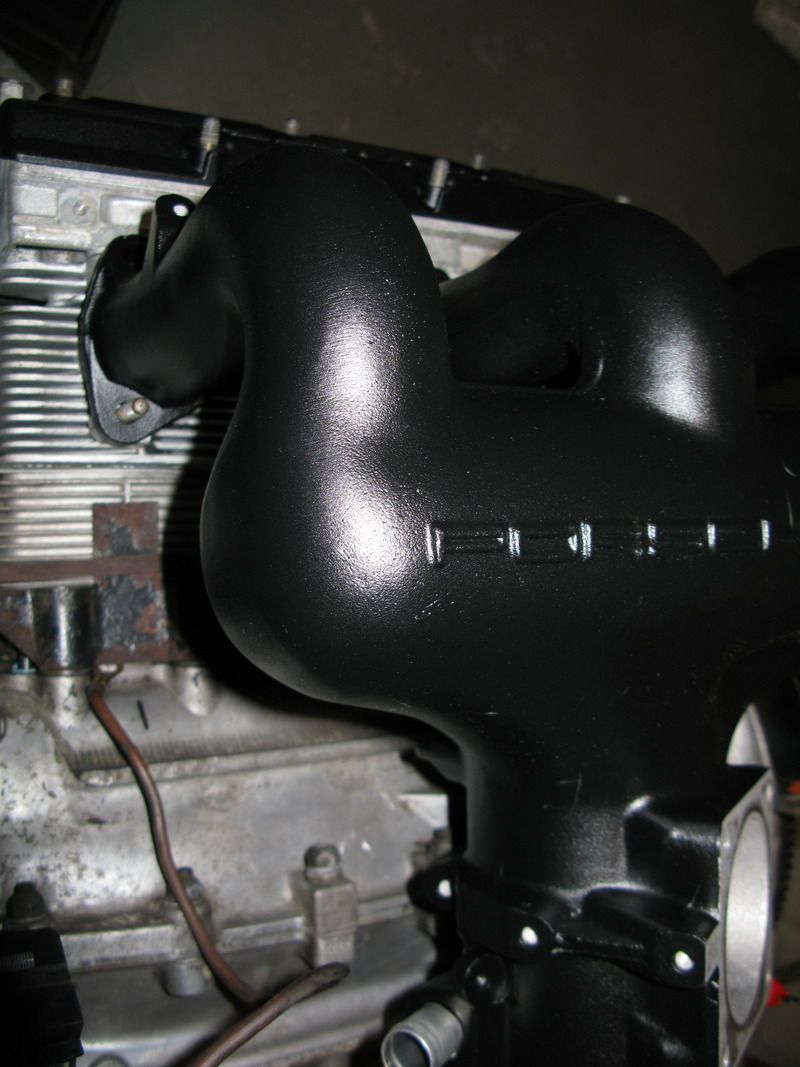

A couple of pics on the Powder Coating update. I sanded (Allie is at her home in DC) the Porsche logo on the valve covers and manifolds, This adds some sparkle to the all black look. 3 minutes with a sanding block. That letters on the manifold are not good. The casting molds must have been a bit worn down.
http://i70.photobucket.com/albums/i1...psyug7qssl.jpg
http://i70.photobucket.com/albums/i1...psj5m6k6lr.jpg

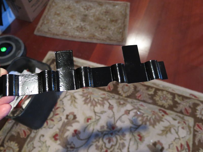

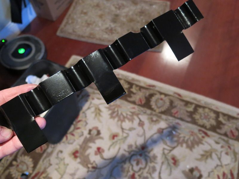

Some mentioned the really ugly air guides and I did feel bad about putting them on but they are 100% hidden so I was going to to leave them BUT I'm project addicted and needed some retail therapy, so I ordered the basic kit from Eastwood. This kit came complete with some powders and I found a really cheep BIG toaster oven, so I set up shop.
I blasted the air guides in the cabinet and then set to doing powder coating for the very first time. The Eastwood gun and powders worked really well and really clung to the part the way they say it will. Some powder goes onto the floor like typical over spray and can easily be swept up. I had the oven pre-heated and ready for the parts once coated. I slid the parts into the oven and because they are thin the heated up and flowed out really fast. They recommend 20 minutes of cure after flow out so I set the timer and cleaned up the gun. After 20 minutes, I opened the door to allow the parts to cool and they came out terrific!!!!
I would have spent $35 to $40 at the powder coater and now the powercoating setup costs me that much less. I have lots of small parts to do as Allie builds the engine and other parts so I'm loving this set up!
Old scabby parts before powder coating. Blasting can't make the metal smooth where the rust had pitted it.
http://i70.photobucket.com/albums/i1...psqy3bfl8z.jpg
Fresh out of the oven!!!
http://i70.photobucket.com/albums/i1...psox2dwjis.jpg
http://i70.photobucket.com/albums/i1...ps22zhwhru.jpg
