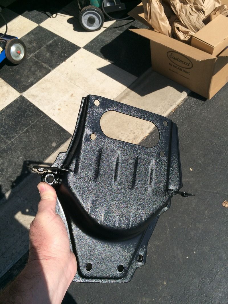

I'm not sure you take the recommendation from a guy that has done a total of 3 pieces!! I can say it's been easy to use, seems to work fine and so far the results have been very acceptable for p[arts there are essentially hidden.
I did that metal mount that goes at the back of the engine and around the pulley. It was really fugly with grease and rust. I sent it thru the ultrasonic cleaner, the blast cabinet and then powder coated it this morning before cleaning up the garage. I used a black crinkle finish and it came out pretty good.

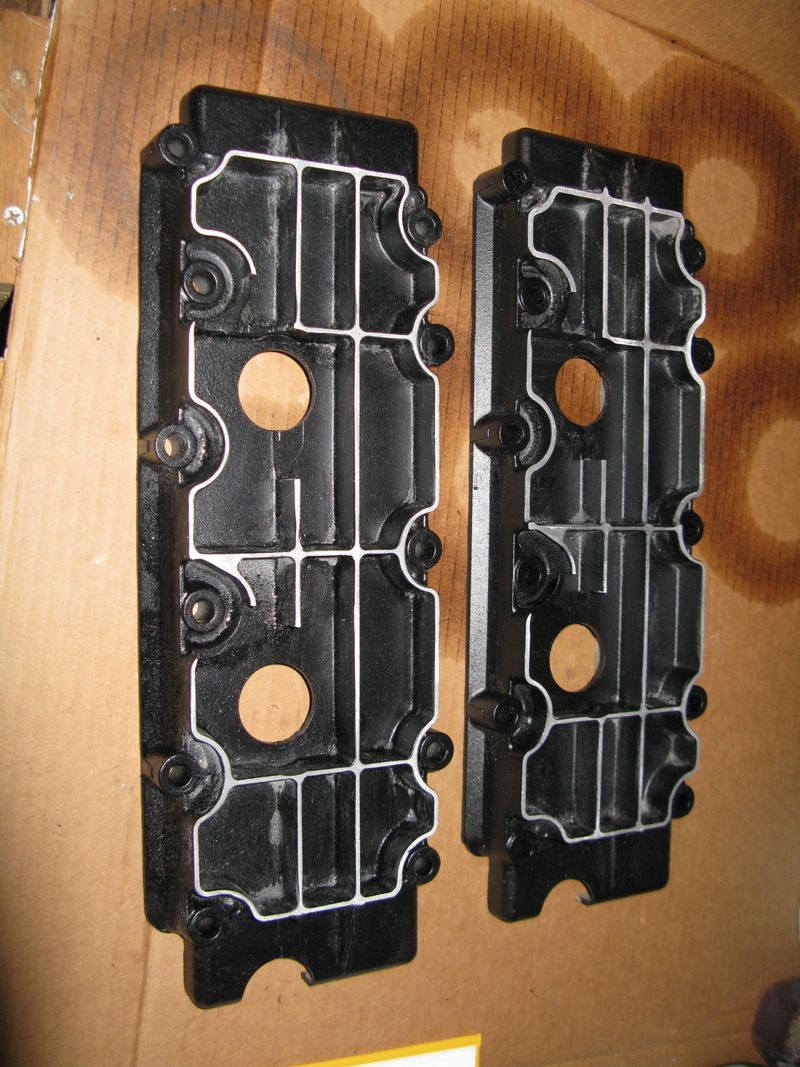

Valve covers are done top and bottom. Sanding the raised portions isn't particularly original but it makes the parts look a bit better.

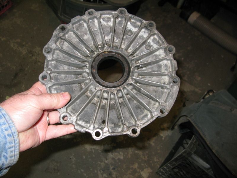

The ultrasonic cleaner has been working hard this week. I have the trans apart and have been stripping that down for inspection. I have done a few pieces so far but the worst and hardest to clean would have been the side cover. It was really filthy, particularly in the ends and small areas. A lot of built up trash from the road. 30 minutes in the cleaner and BOOM all clean. NO hand work done at all and the water/dawn dish detergent in the cleaner is looking very ugly. Still soapy and bubbly so still effective. I have not used my mineral spirits cleaner since getting the UT cleaner. I do NOT miss the fumes and splashing of the cleaner onto my clothes.

Trackrash 04-27-2015 05:09 PM
Have you tried TSP? I have been using it with good results lately.
Have you considered a Carrera side plate. Might help contain that 3,4s torque.

Jcslocum 04-27-2015 08:03 PM
TSP is strong stuff and I find that the water and Dawn solution is doing a great job so far. Could be faster I guess but I'm in no hurry usually.
I have not looked at the carrera side cover. Time for some research!
