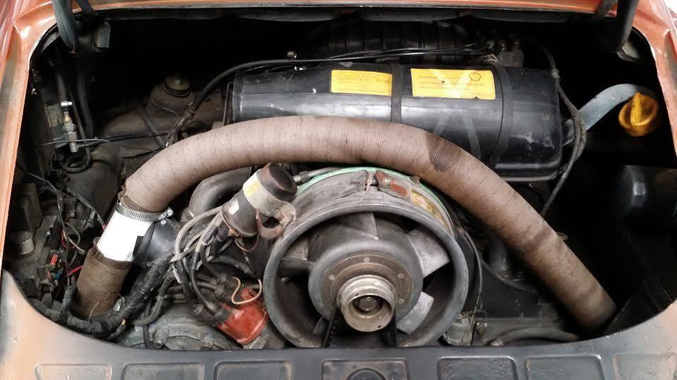

Hello Gang,
70' 911t/ 76 2.7l engine
did a compression test ;(
left
42 psi, 115psi, 90psi,
right
117 psi, 117 psi, 115 psi
…going to put oil in to the"42psi" cylinder to see if its pistons or valves.
PS: Car sitting for a long time, changed oil & spark plugs (spark plugs BLACK) hence us
doing a compression test.
ANY ADVICE on what to do next???
Thanx
R
Take it apart.

Rogue - I wasn't really kidding before about the eng. I would not bother with a leak down or whatever. The numbers say take it apart. Plus you have to do the Racewares/counterbore on a mag eng anyway. A must.
I also see that you need the fan w/ more blades. There's a guy that restores the fans and rings but I had mine glass beaded and I painted this stuff with epoxy.
It all depends how far you want to go and how much you want to spend. I want something reliable and that looks nice when I open the lid. For you to get there on what I see just with the eng, if you have somebody else do the rebuild, you're looking at $15K these days and that may even be optimistic.

MY GOAL IS TOO GET HER STRAIGHT AS A DAILY DRIVER & SELL.
My friend who is a decent mechanic says its the valves. He did the "oil in piston test". Im going to take her in to get a look. Anyone know of a good porsche mechanic with "Valves"??? In Los Angeles??
"do the Racewares/counterbore on a mag eng anyway"
…will do on the smog pump
This means?? sorry I'm a newbie
Thanx Casor

How many miles on this thing? Do you know the history by chance.
If you have a magnesium case engine - this means the "engine block", where the crankshaft is - then you run the risk of one or more of the 24 head studs pulling out of the magnesium because it's a bad material for this application, previous overheating, and just plain age. You can see the silver head studs in the attd pic on my recently rebuilt engine - they are exposed to the elements. On top of all this, the older "dilavar" would tend to rust and fracture if they were scratched or old. If you have dilavars, you have to get rid of them anyway.
To greatly reduce the chance of the new head studs from pulling out of the magnesium, the engine case has to be bored where each one of the threaded holes are that anchor the studs. Then a thing called a "Time Cert" is threaded in ea hole and the new studs thread into that. The TC's greatly increase the surface area in the magnesium case that the studs are pulling against, thus greatly reducing the chance of them pulling out when the six cylinder heads are torqued down by the 24 head studs.
So, the point is that the cam towers, heads and cylinders have to come off do all this. You have to already take the heads off to do the valves, so you are not that far away. You don't need to disassemble the entire engine block - only all the stuff down to it. I recently had all this done and it's expensive. The new studs, nuts and washers are almost $1K alone - plus the labor

Rogue - I read your post again and you said you want to fix it up and sell. I hope you got this thing cheap. Just to open up the engine is $3-4k in labor. And nobody who knows anything (ex me!) is going to buy it w/o the above mentioned work being done. And the above assumes you are going to pull the engine, pull off and pile on all the crap on top and then stick it all back in. And then if you don't do anything with the stuff on top, the thing will still look like hell. Bad for marketing.
