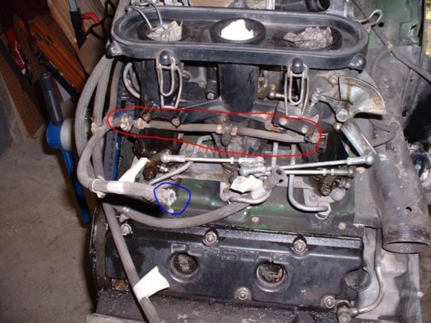

Rot 911 02-26-2003 11:42 AM
In the past I have used a generic engine stand and like others have said with the exception of the hassle with not being able to rotate the engine 360 with the heat exchangers I was able to work on the rest of the engine. However, having said that, I will probably use the Porsche yoke when I rebuild my 3.2 engine next winter. In the big scheme of things $300 is not that big a deal. And seeing how crazy the bidding gets on ebay, I might be able to sell it for more than I paid for it. By the way, my 2.4 engine was on the generic stand for over 3 months with no problem.
Before:
http://forums.pelicanparts.com/uploa...d Start111.JPG
After:
http://forums.pelicanparts.com/uploa...inepict222.JPG
