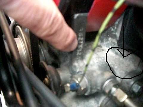

Help identifying engine, where to look for numbers?
I have been cleaning up my late dads storage and found this engine the other day. Quick glance I didn’t see any numbers stamped, so not sure where to look.
Any insight on what year/model it is.

Search is you answer....the number you are looking for are here look..where is the finger and also where is the circle

Unless it is a 914/6 motor.

Hi to Oregon..maybe you could show him where the 914/6 number would be ..or??

914/6 number s located by the thermostat and case breather.

From our host.
Pelican Parts: 914-6 Engine Serial Numbers
Image courtesy of the interweb.

so, what gives it away as a 911 engine is the oil pressure switch partly covered.the 914/6 has an oil press sending unit in its place.So it is a 911 ..which one, to be continued

Ok it says 6196145 on the block.

and the number where the circle is? something like 901/16....?the other number points to 1969 911T
ivan
Ok, other numbers are
901/16
21729

so here you have it it is 1969 911T...
