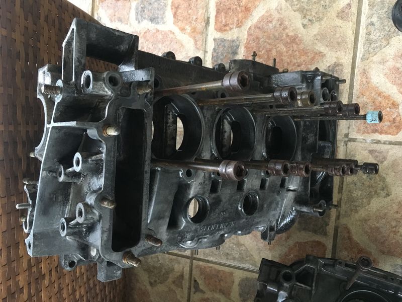

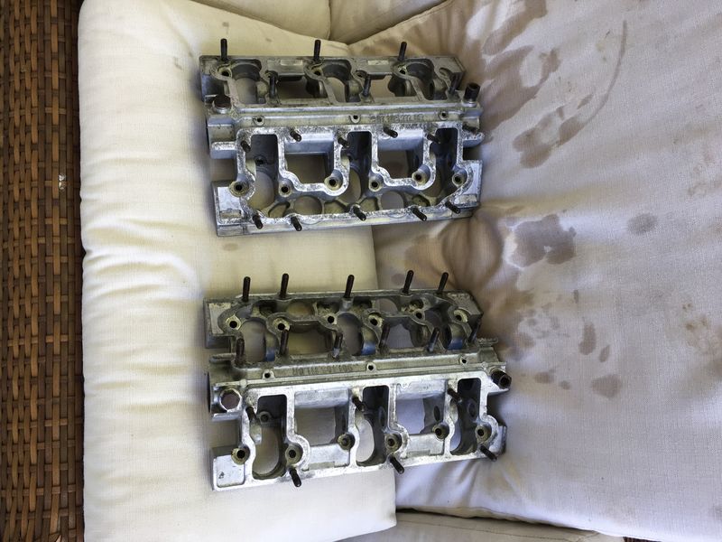

I worked with this today.
Good results on my case and cam carriers
#147 of 2096
What cleaning solution did you use? Was it heated? How long?
Gordon
'71 911 Coupe 3,0L outlawed
Old 02-25-2018, 05:09 PM
#147 of 2096
Join Date: Jul 2002
Location: Puerto Rico
Posts: 1,699
It is called H7, it is a degreaser.
Two hours, no heat.
I had to scrub some but good results
