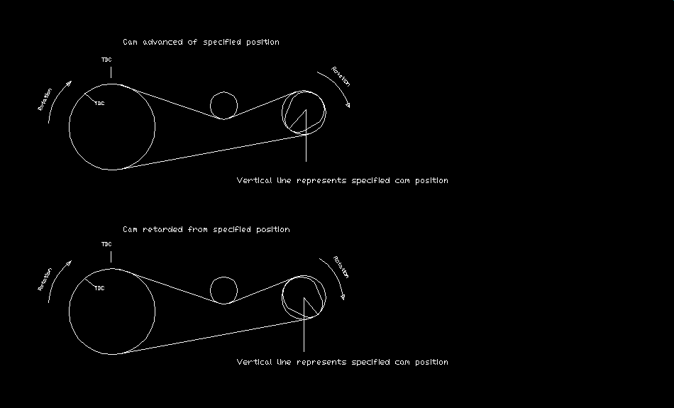

Lets put this to rest... I made a cad drawing at work today....
" a pictures worth a thousand words"
I know that you can move youre HP and torque peaks around....dont know about making MORE torque or HP

This is correct if the TDC marks were lined up and the rest unchanged.

Tim,
I see where you are coming from now. The "specified position" using the Porsche/valve lift method is very close to the start of the lobe (not the lobe center). Advancing the cam timing would always result in a larger value - unless you advanced the cam timing by like 50 degrees, enough to go past the lobe center.
Using your original example, the timing would be retarded, not advanced.
"If your cam spec is 5mm, you really read -5mm on the dial gauge. So if you set your cams at 4mm (-4mm), the cam has progressed further in its cycle (advanced)."
