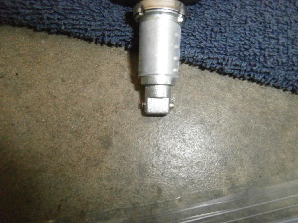

Thank you Anton Largiader for the directions listed in this thread. The directions worked perfectly because my key would still turn to the ON position. In the ON position with the ignition key in place there is only a Spring-Pin holding the lock cylinder in place and that pin can be released by pushing on it through the slot Anton described. Then the lock cylinder does just pop out of the bike smoothly and easily.

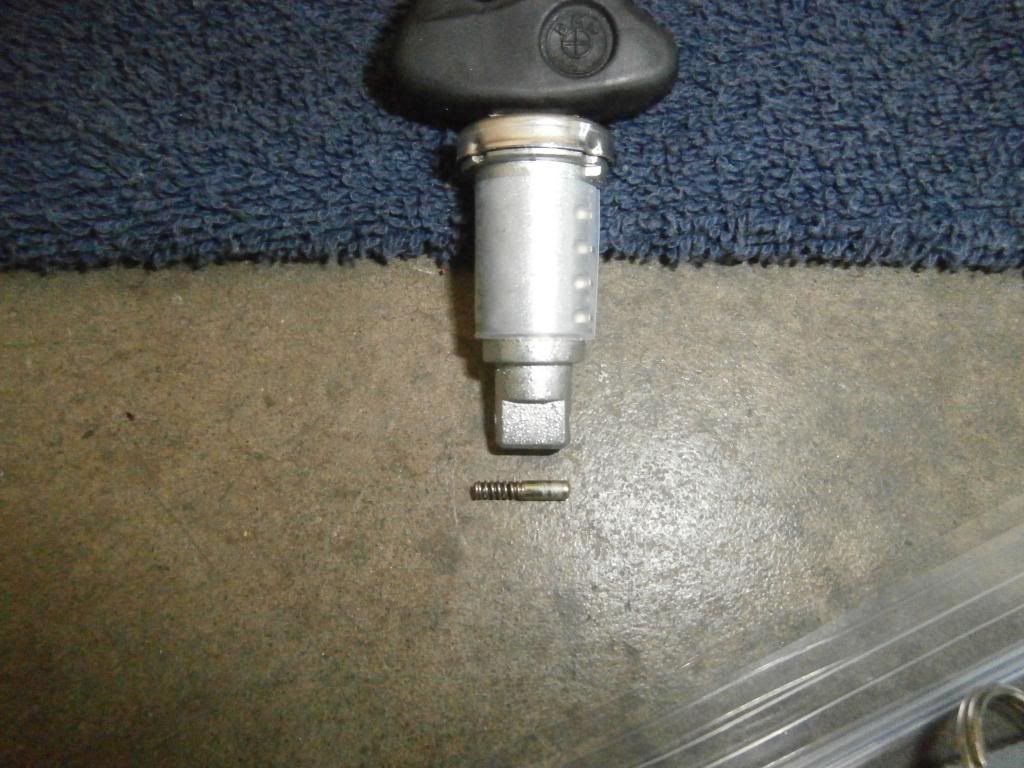

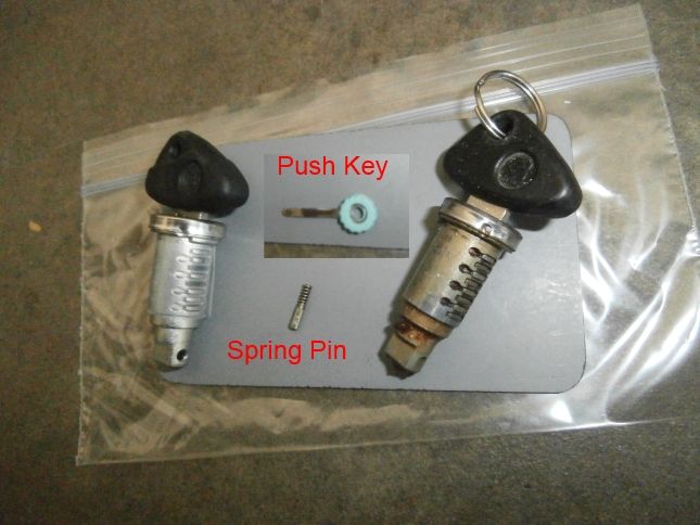

I bought a new lock cylinder (BMW Part No. 51 25 2 313 286. BMW Part Name: Steering lock.) from BMW for $31.92. Heads up: If the key is not carefully pulled out of the new lock cylinder, tiny pieces start falling out like a disintegrating 3-D puzzle. The BMW tech did have to collect a few parts. Then he matched the new cylinder to my existing key for free even though I had been quoted about $40 for the key matching. One thing about the replacement lock cylinder, the new cylinder had a one-sided hole for the Spring-Pin. I don't see that working. I drilled out the closed side of the hole so the spring-pin from the old cylinder fit all the way through the new cylinder and everything was the same going back in.

This Spring-Pin is the important piece. The new lock cylinder did not come with one and it did not accept the old pin in the same way until it was drilled to match the old cylinder.
After drilling the pin fits as in the old cylinder.

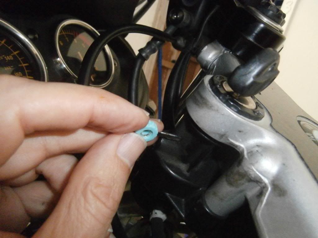

I made a Push Key by grinding down a luggage key. It fit perfectly. The Spring-Pin needs to be pushed down when removing the old cylinder and when putting the new cylinder in place. The old cylinder came out all greased up, the manual specifies Shell Retinax A. One of the side pieces on my old lock was dinged.
Here is the slot for pushing on the Spring-Pin. The lock cylinder must be in the ON position with the ignition key in place. The slot is out in the open and easy to reach.
After I finished installing and testing the new lock cylinder, I think it might be possible to complete this job without the new lock cylinder. I had a slight ding in one of the pieces that fits into the side of the lock cylinder. The ding was easy to see. If I understand the little dinged piece correctly, it might be workable to simply remove the dinged piece and put the old lock cylinder back in the bike. After removing the lock cylinder from the bike and very carefully removing the ignition key the dinged side piece should just slide out. (All the side pieces seem to want to fall out without the key in place.) This could possibly work if a key stops working while out riding as long as the key still turns to the ON position and some sort of push key can be worked into the slot to free the lock cylinder.
