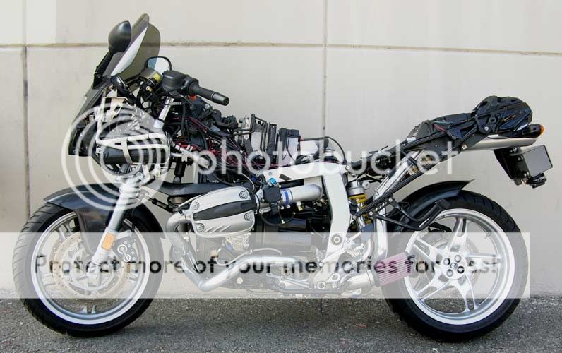

Gentlemen: May I present to you....
....the first, and possibly only, Turbocharged BMW R1100S.
'01 BMW R1100SLA. Turbo.
< = > Less is More.
If you think you know it all, you obviously don't know anything.
Old 10-18-2010, 11:59 AM
motoman's Avatar
A few quick answers:
1. Yes, this was designed and installed by RB Racing, the gifted but eccentric engineer Bob Behn.
2. Yes, he had the bike for over 5 years.
3. Bike runs normally up to about 4500RPM, and then things start to happen.
4. An intercooler as well as a water injection system is installed.
5. Large LED gauge on the dash displays left and right exhaust temp, and system pressure in BAR.
This web page will explain more details:
http://www.rbracing-rsr.com/bmwR1100.html
6. Has not been dyno'ed but seat of the pants HP is 130-135 at 5K RPM, 7 lbs. of boost. No water injection is required at that pressure.
7. No, given the choice I would not do it again.

Pretty wild setup!!!! Turbo's are not easy to install especially on bikes...How does it sound??? Any videos?

Gotta wonder how much boost a boxer can take...are the pistons forged? What are stock internals like?

so that's the one he has pictured on his site?
water injection box behind the left rear cover?
