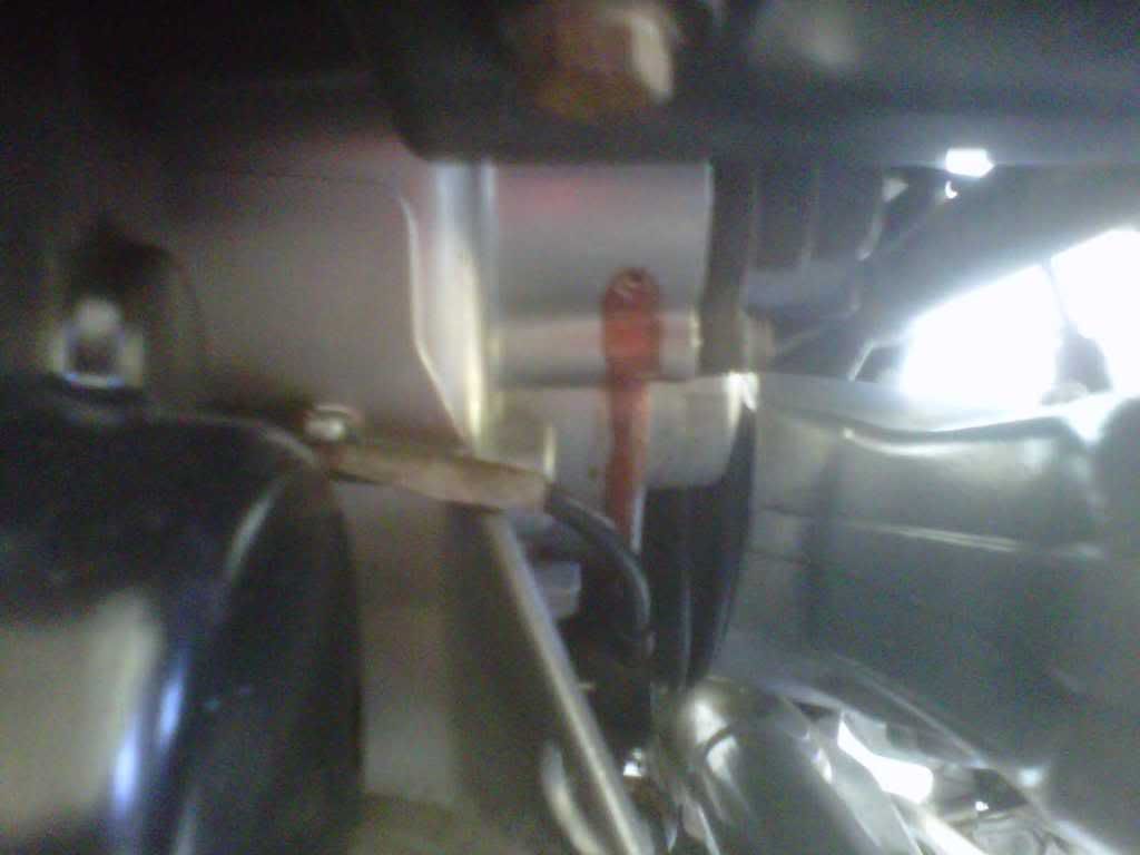

As some of you may know, I just got finished replacing the clutch assembly in my '99 R1100S due to a clutch slave leaking which of course ruined the clutch disk before I had any evidence of its failure. Well, I installed a weep hole in the transmission to give me warning should that ever happen again. I got the warning sooner than I figured and it wasn't the clutch slave this time. It's the input shaft seal on the transmission itself which bits the big one. The weep hole will probably save the clutch disk this time; however, I don't look forward to splitting the bike in half again so soon after having done it. Maybe it's time to get that GS I looked at on the showroom floor yesterday.
Red line shock proof coming from the weep hole I drilled.

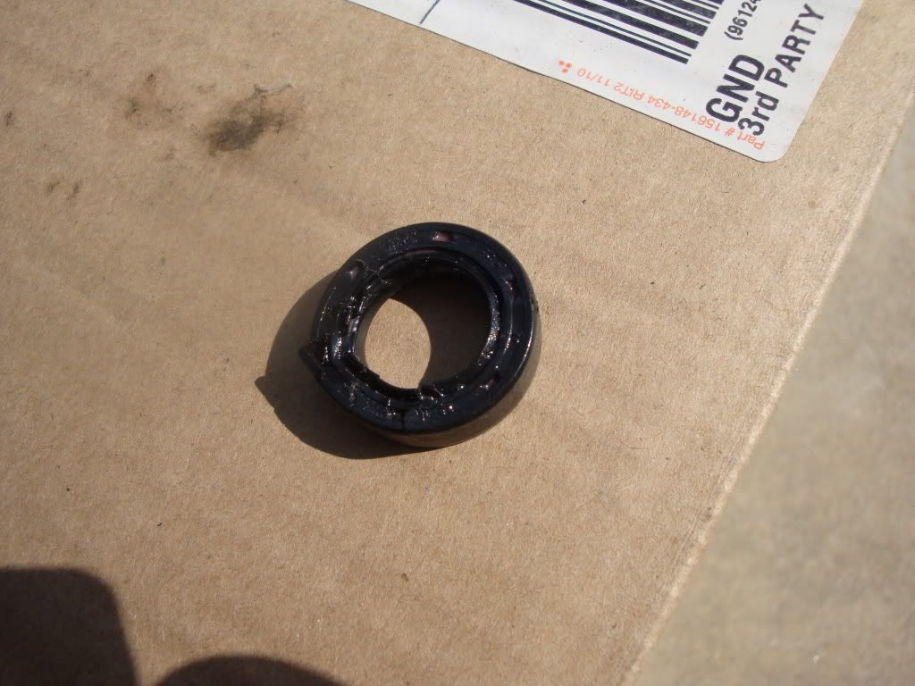

Posts: 11,161

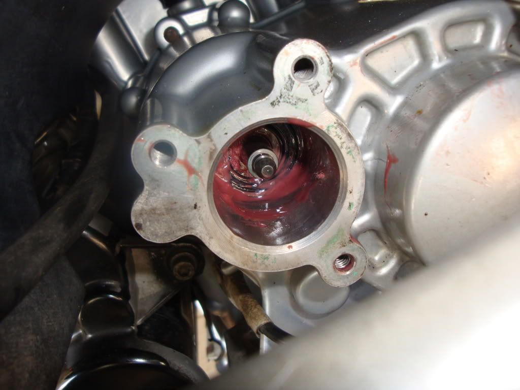

I assume that the Dot 4 brake fluid from the leaking slave trashed the seal. I missed that one.
This is what it looked like when I removed the clutch slave.

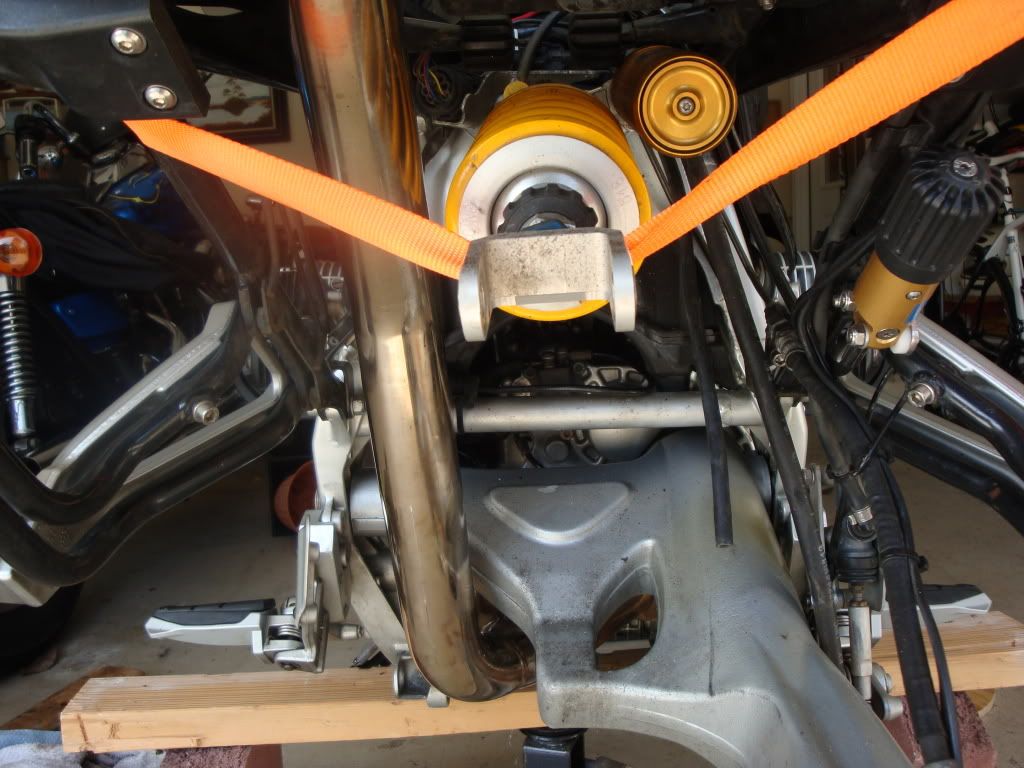

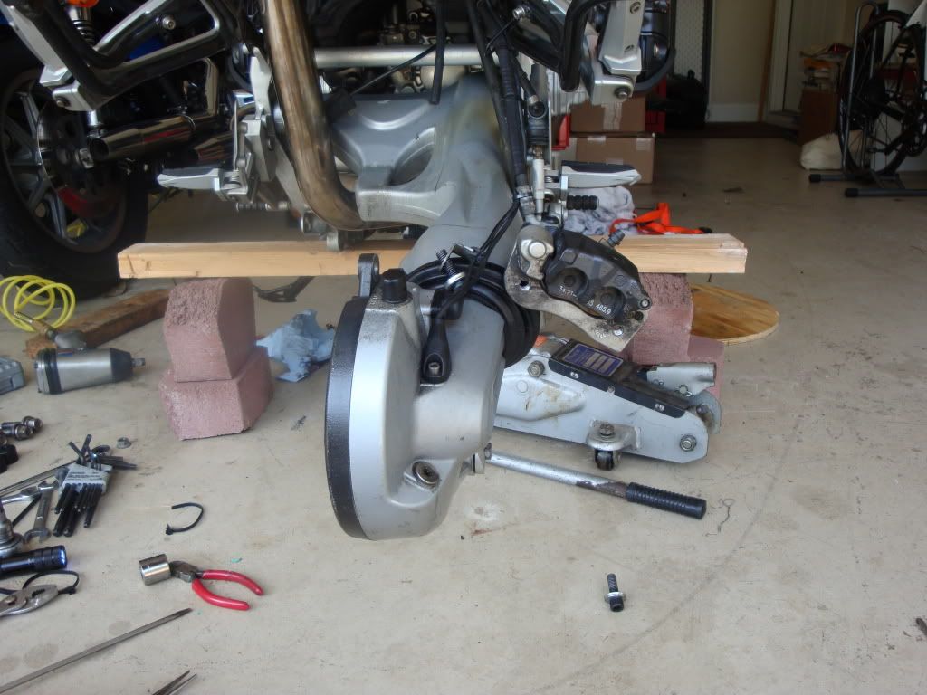

I got up this morning and rigged up a stand so that I could start on the rear transmission seal replacement project.
That's the seal around the input shaft where the clutch slave is mounted.
After erecting a make-shift stand that would allow me to remove the rear wheel and bottom bolt on the rear shock, I proceeded with the removal and tied the rear shock up out of the work area.
I had assumed that it would not be necessary to remove the Y-pipe on the exhaust and the assumption was correct. With the wheel removed and the shock out of my way the obstacle was he 1/2" support bar on the rear main frame.

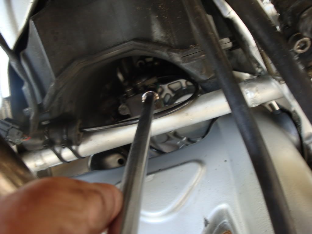

I was able to work around it, however. I proceeded with removing the clutch slave and was able to move it off to the left to gain clear access to the seal itself.
The weep hole definitely saved another clutch replacement.
There was still considerable Red Line lube in the clutch slave cavity.
I cleaned out the cavity and attempted to remove the seal using the screw in the seal pry out method. This didn't work due to the smallness of the seal itself. I used an inspect pick to move the seal. I found that the Dot4 had done its damage to seal material making it quite pliable. Using the pick and a long 1/4" blade screwdriver, I was able to remove the old seal with damaging the metal on the shaft or the transmission housing.

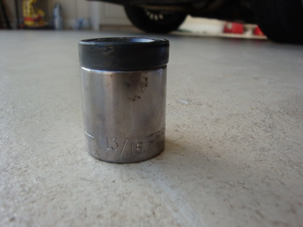

I determined that a 13/16" socket would be the correct tool for pressing the new seal in place. After lubing the lip of the seal that contacts the drive shaft, I got the inner diameter lip onto the drive shaft and then used the socket to press the seal in place.
From that point on it was simply a reversal of the components that I had removed. I did a 20 mile test ride and there doesn't appear to be any leak at this time.
