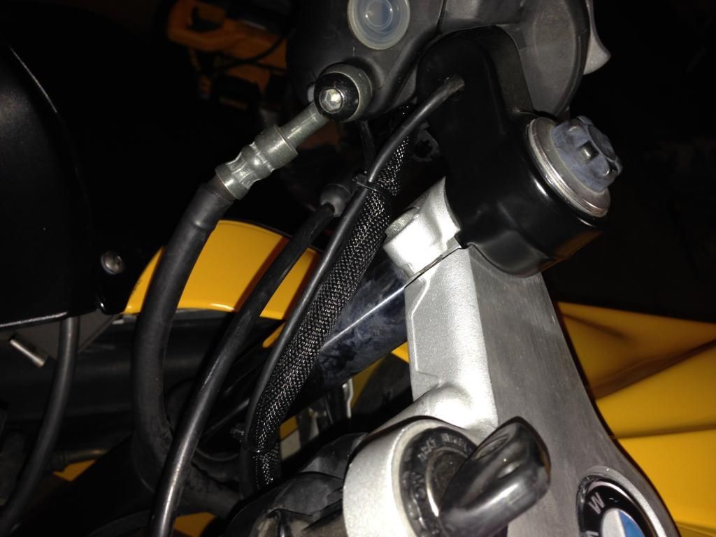

Was washing the bike today (it was filthy), and noticed that the protective tubing around the wires coming from the handgrips is cracking and failing. Here are some images:
Suggestions? Is there a wrap that would work to protect these wires? Or do I have to disconnect everything and slide some tubing on there? What do you guys recommend?

For a quick fix, there is two kinds of wrap available.
Split Loom and a Spiral Wrap, both work equally as well, but the split loom is a little easier to apply and I think it looks neater for this application.
Check electrical supply outlets or auto parts suppliers.
Cheers

Hello;
This is what I have used
Weatherproof Cold Shrink Tape
Part #85274
Auto-Zone carries it, work great

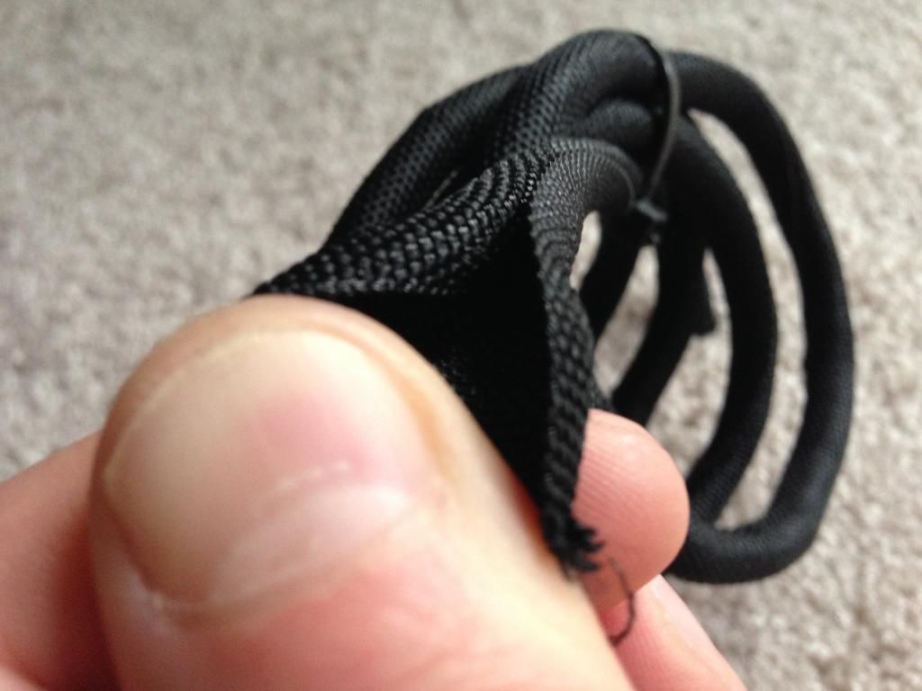

I HIGHLY recommend this stuff. I just did this project on my '99 S 3 weeks ago. It's not super expensive, it was very easy to install, it looks really good, and it feels like it will last for the life of the bike.
I bought the 5/16" diameter, 10ft length. I ran it for both wire looms from the hand controls to the relay boxes, I had a little less than 3 ft left over.
Russell/5/16 in. dia. x 10 ft. Wrap-It wire sleeve (629090) | Wire Sleeve | AutoZone.com

Used the same as proposed by EZ rider, for a damage to that exact same wire you show, 3 years later it is still working perfect.

Prepare to find out nearly all of the wires are cracking and crumbling like that. At least that is what I found on my 99 R11S.

BMWR502, that is a nice alternative, but my only concern is that there's a slit in it which could let water in. I actually bought tesa tape from a guy on eBay...$17 a roll but I like your idea and EZ-Rider's idea better. I'm on the fence on what to use.

Meh. The wires look good. It's the protective tubing that's done for.
But OK, I take your point, and it is time for a new battery. Might as well pop up the tank and have a look around in the snakes nest under there.

Understandable concern... the split in the loom doesn't just "butt" together though, it doubles over on itself and holds a very tight curl. Being behind the fairing, I would think it would be fairly difficult for water to be forced into the loom.

Question for BMWR502
BMWR502, hoping you see this post or the PM I sent you. Do you remove the old wire covering before you installed the Wrap-it split wire loom? I now have some wrap-it on hand, but it looks like it will only fit if I cut off the old stuff. Thanks. Doug
