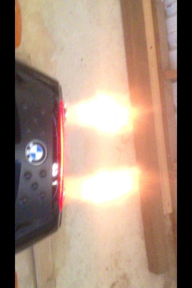

R1100s
Join Date: Apr 2012
Location: Australia Tasmania
Posts: 531
I like it
