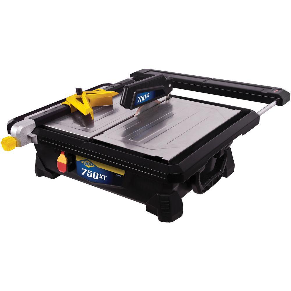

We have 2 wet saws for the 'business', a sliding table, and a sliding blade.
However, I've done quite a bit at a vacation house with a harbor-freight angle grinder with diamond blade, and a sub $100 wet saw. In many ways, with the larger format tiles common today, the angle grinder and cheap wetsaw are easier. If you use the grinder, just mist the tile with water to keep down the dust.
LOL, that's me. Under $10 for the HF diamond blade.
That, with a regular old tile scorer-breaker will just about cover everything I've needed to do so far.
But it might take longer and i usually end up with more "sample" pieces.
A few weeks ago I almost broke down and bought this for $65 but got by without it:
