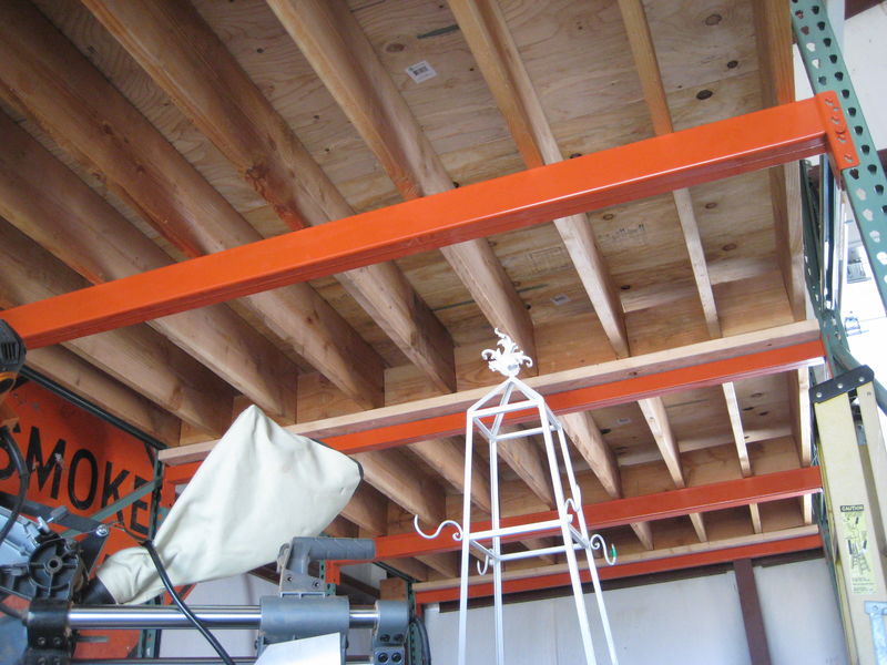

Are you using a good chop saw to cut the blocking pieces?
I did the cutting for a lot of the blocking that is going into my brother's new place.
This is the bottom side of what he calls the speedster hut.
It's all screwed together.
Scott

The question about blocking I cut most by hand with a circular saw . Put a square on each one , made my pencil line and cut it . I am not and never will be a finish carpenter .......... sometimes good enough has to be good enough 😁

My brother and I have been doing a lot of construction at his new place the past 6 months. We've been using the heck out of his chop saw. It has turned into a production where time saved measuring etc helps so I worked out a 'stop' system where once the first block is cut/measured/inspected for length, all the rest of the blocks for that 'section' are the same. It's worked out great and we've seen our 'build times' decrease greatly the more we've done. What at first took us the better part of a day to do can now be done in a couple hours. Practice makes perfect.
I hope to be able to show you all pictures of what we've been doing. I'm hoping you'll like it.
