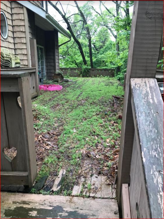

OK I will predrill any that are near an end hopefully I can keep them back about an inch from the end . Today I picked up enough material to get the blocking started . I completed one out of the four main runs with blocking . Tomorrow I hope to get another run done . My cheap Harbor Freight framing air nailer is chugging right along I can't imagine driving nails by hand anymore Here are three pics of the mess I am replacing . The pics don't do the decay and damage justice the top boards are a wreck Just a little maintenance by the previous owner would have gone a long way . But I will end up with a much nicer top surface .

Today I finished the blocking on the deck in front of our master bedroom . I used my circular saw to cut about 2 ' off the ends of the existing boards . This will allow me to stand on the existing boards when I install the picture frame boards . It was near 90 degrees here today I put in a solid 7 hours and I am beat 🤤
I am going to power wash the joists from below that is the next step . Let it dry for a day or two and then the joist tape goes down . Then the picture frame boards . Very slow going I am feeling my 61 years 😁 But I am hoping in the next few weeks the deck will be complete on the master bedroom side . Then I will switch to the other side and last will be the joining walkway . Not pic worthy at the moment .
