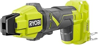

I just did some PEX work in my garage, and picked up one of these to do the crimps. AMAZING Tool! And well worth the cost.
