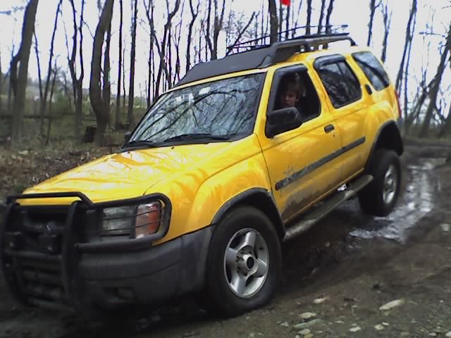

I'm in the top picture...it was a little bit scary the first to get the wheel in the air, but you quickly get a feel of where the cars balance is and that was relatively safe. However, that is my friend in his Xterra in the second picture. He did not take the line that we had planned for him and he was teetering on the edge. We eventually had to hook up a safety strap to him to make sure that he did not flop it.
