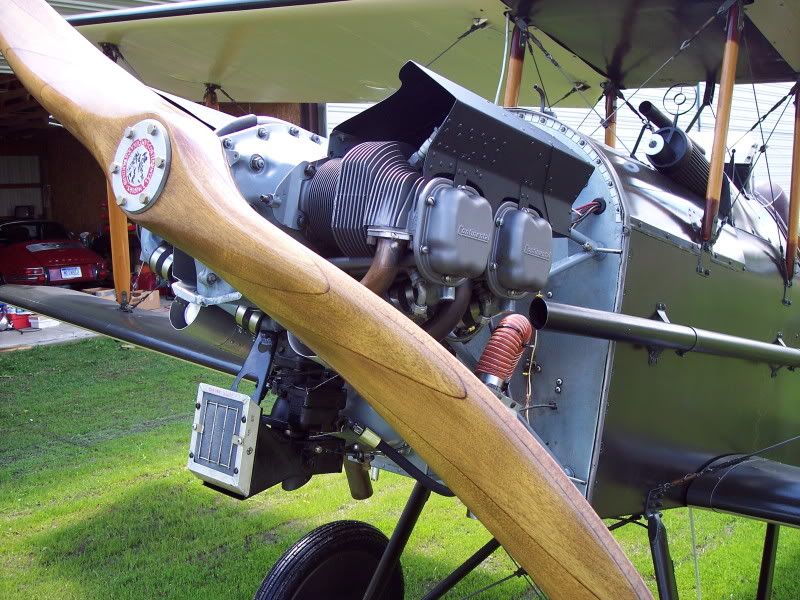

Top end done! Back in the air!
Decided to pull the cylinders on the O-200 for a top end, new exhaust guides, ground valves, seats, new rings etc. Repaired the oil pump cover housing which was just about shot. Ran it up today and got 50# of pressure and 40# at idle, need about another 15 min on the ground then back in the air, finally!! We were getting around a quart of oil every 2 hours, the exhaust guides were really shot.

Its certified under the experimental classification and its only 1150# gross so its also under the sport pilot class so its rather cheap to maintain, total cost to build was around 10K with the engine but that was back in the late 80's The only thing I have is a youtube site you can check out a few vids if the plane:

Any leaks Craig? I bet you feel good knowing she is all up to par internally. I will have to keep an eye out for a flyin between us to meet up at this summer.

So far so good with the first run up, Looks like it will be nice tonight so I will get her up in the air and get some time on it. We did crack the case open just to check things out, it was back in 2000 when we put the O-200 crank in it and everything looked excellent.

Just got back down, That was the most boring thing I have ever done, one hour of nothing but circling the airport in 55 degree weather with not much heat. All seams just fine, no leaks at all.
