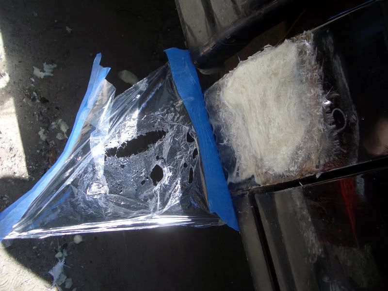

Cab hole; This was repaired once before, opened it up and not a lot left to work with. I took a can of spray foam and let it form a backer (despite knowing that it may absorb moisture over time). I chopped up some fiberglass strands and epoxied them, using plastic wrap and tape to defeat gravity.
Micro balloons and or fillers mixed with epoxy resin have a pink hue.

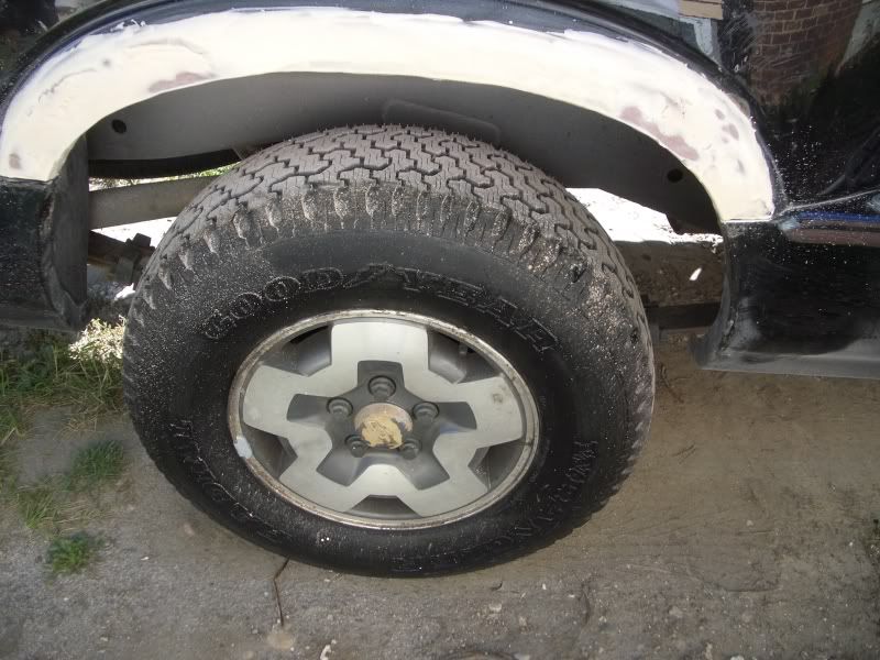

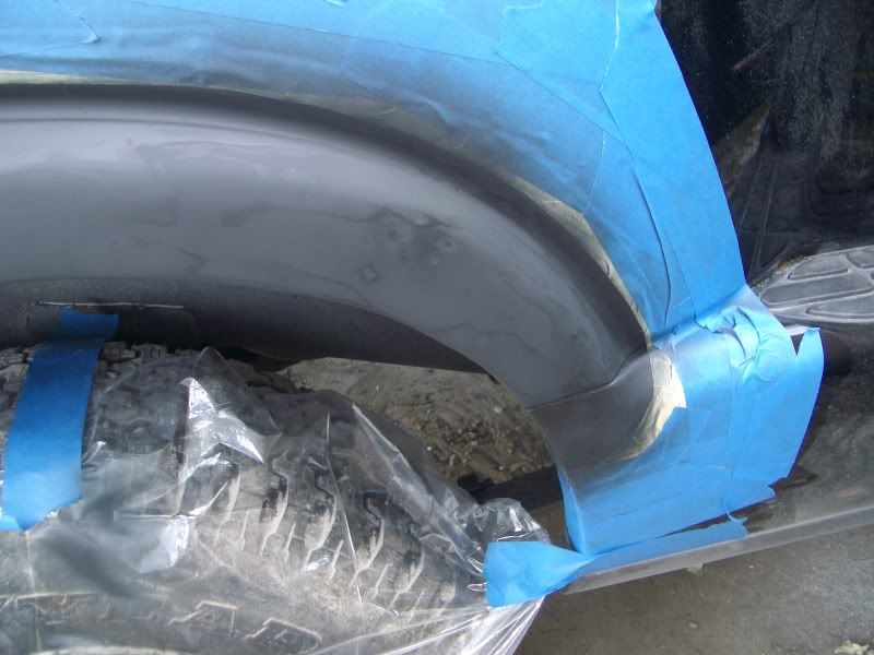

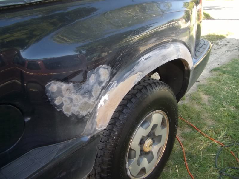

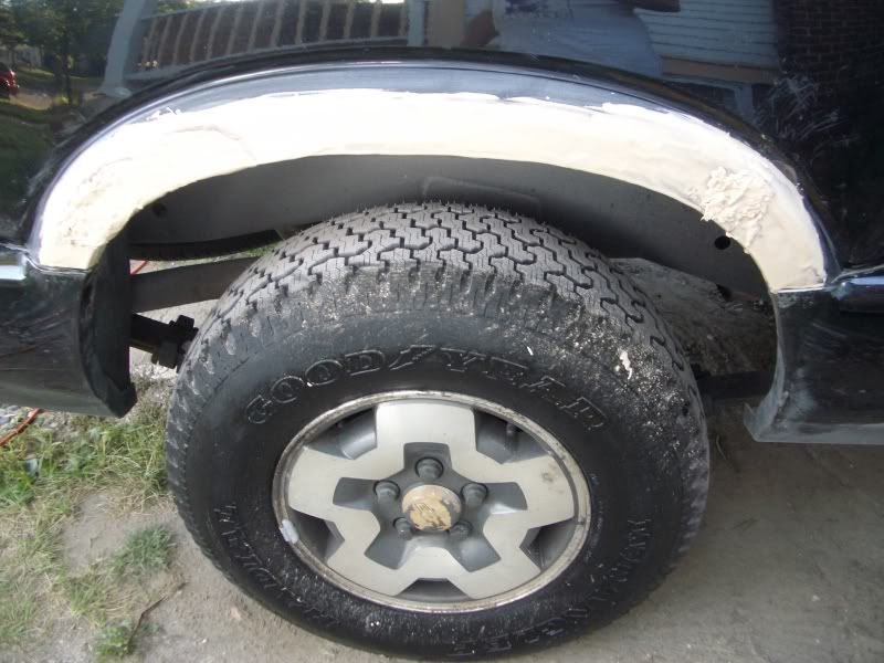

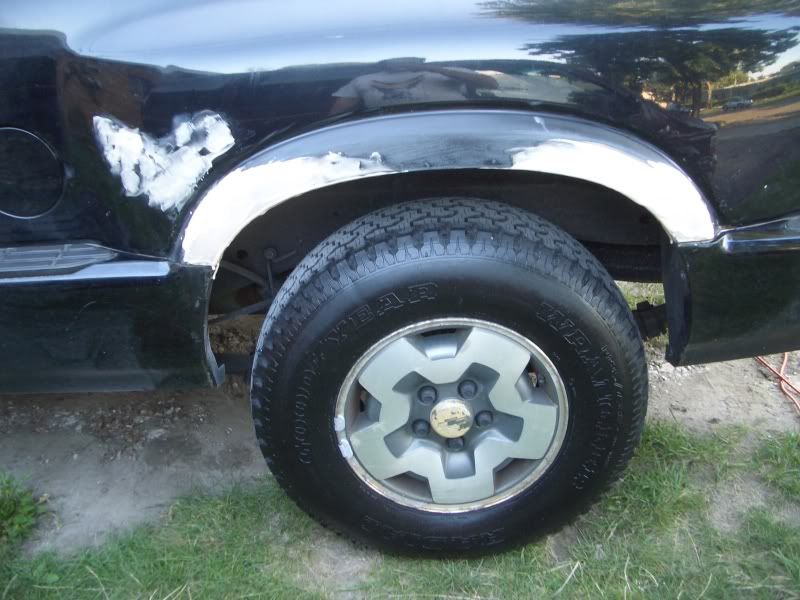

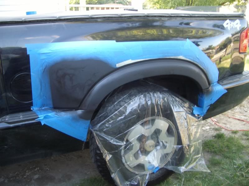

The wheel wells; were started months before and then restarted, more work to finish than I expected. I already purchased some Pace rubber lips for the arches, but wanted it solid and strong to hold screws and take doors swinging open on it.
Surface bubbles from rust on the other side, sprayed Permatex behind there but that's not going to buy much time, rust never sleeps.
Putty, sand, putty, sand............
Prime.
Dang epoxy blisters/pimples kept coming back.
Paint.
Need to blend the paint line better in spring when I Zebra stripe this truck. 8)

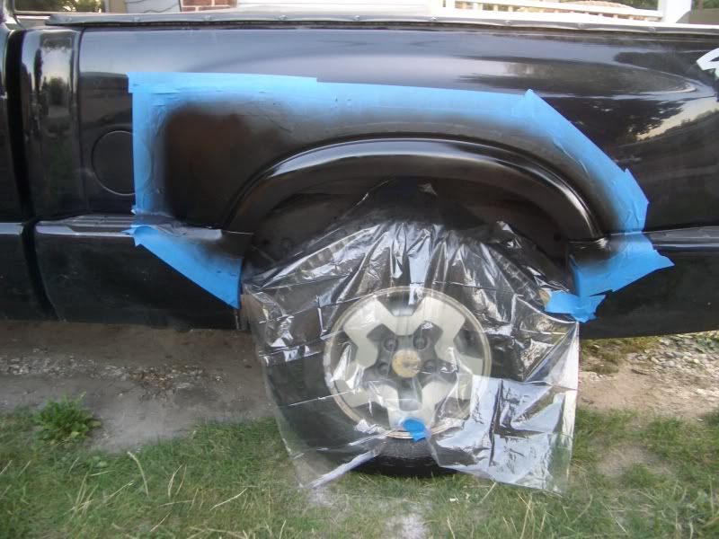

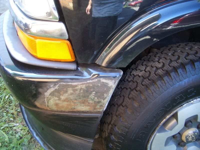

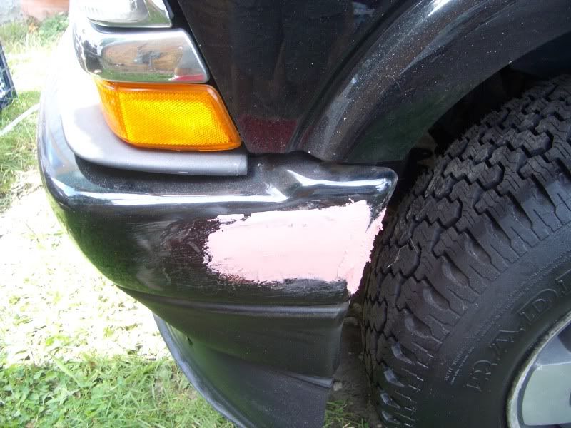

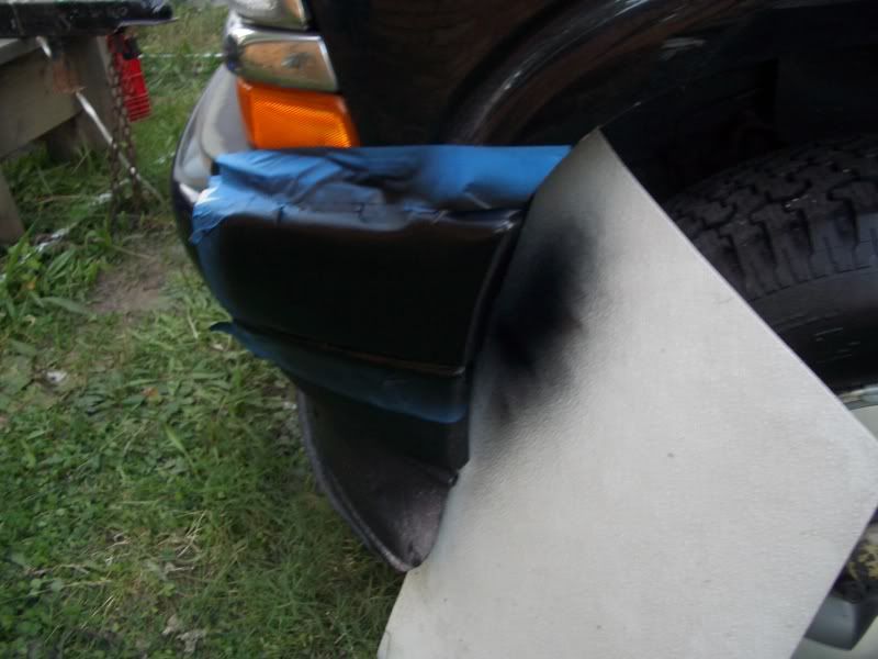

Bumper scrapes; were a bit larger than I thought, held them at bay this winter with some naval jelly which turned them black for a while.
Used black primer and black paint, I will not bother with a blender for the paint line here.
Pre-Flare:

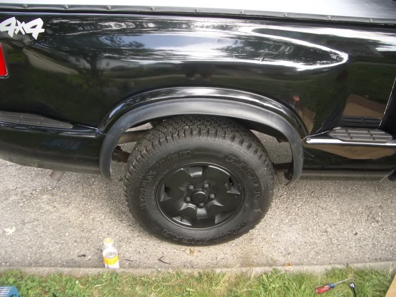

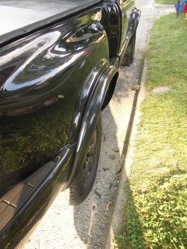

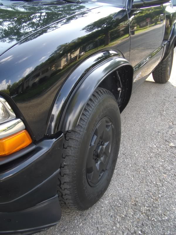

Flares again; Not for everyone, a nasty bit of rubber serving a purpose for which it was intended. Not so bad looking at some angles, other angles are painful to look at, a nasty bit of rubber. I'll live with it, have to, too many screws in there now.
Before flares:
After flares:

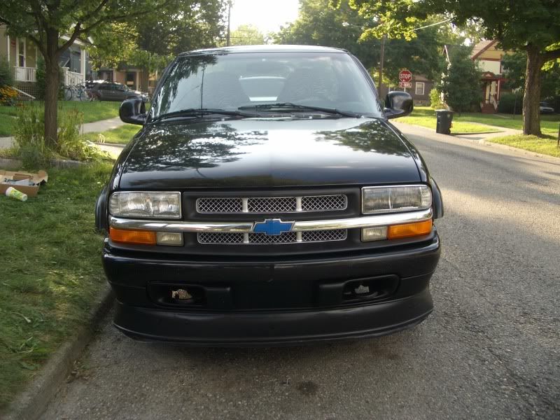

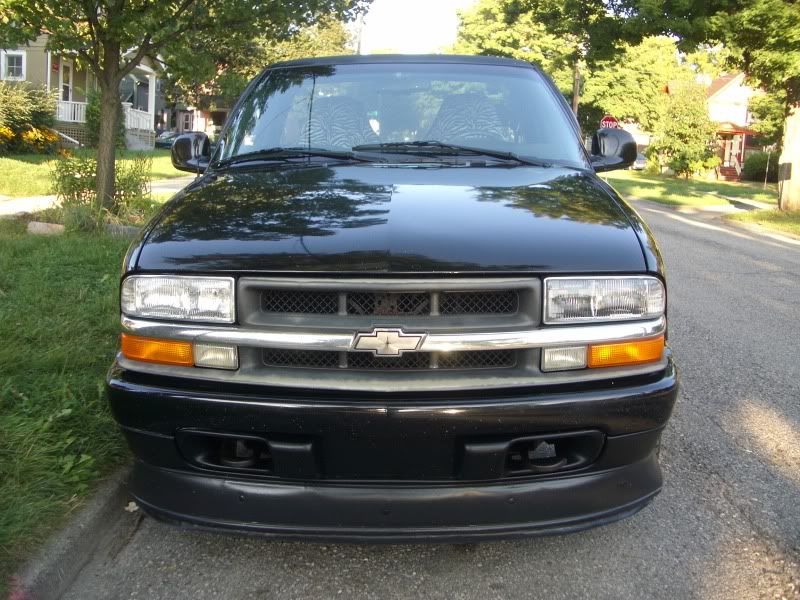

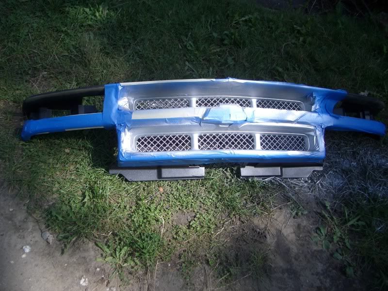

The Grill: before
Removal;
Tool handle spray rubber, chrome paint for plastics and Krylon True Blue (just because).
Old 10-24-2009, 06:53 PM
Posts: 54,011

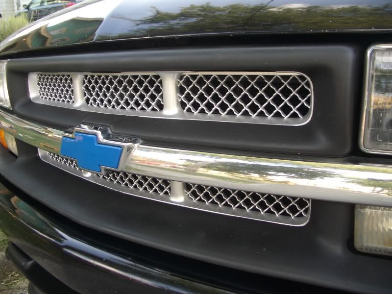

Grill details:

You can see what I mean about not being so good looking up close and at every angle. Like the wheels need spacers now, or I need fatter tires.

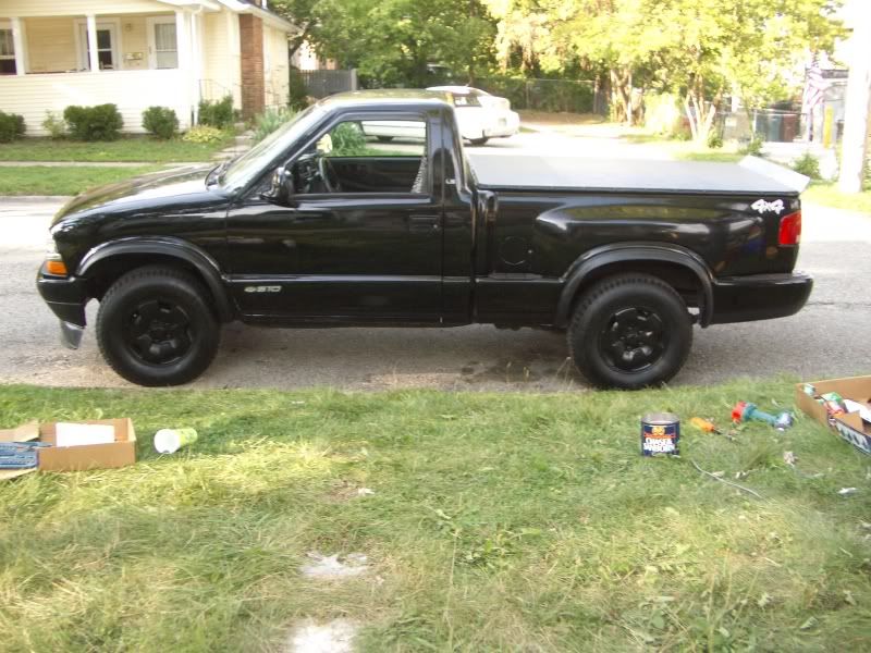

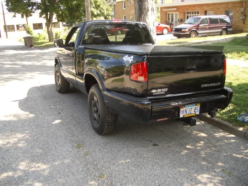

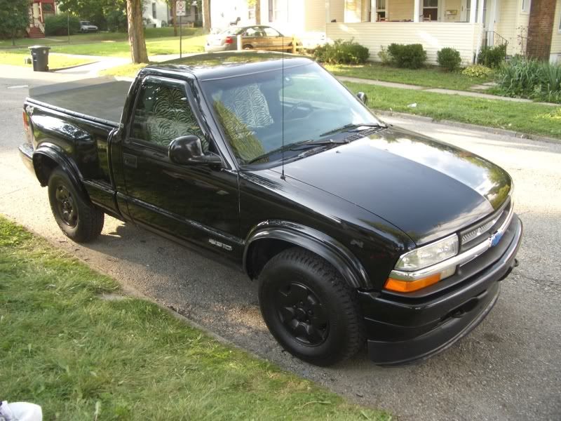

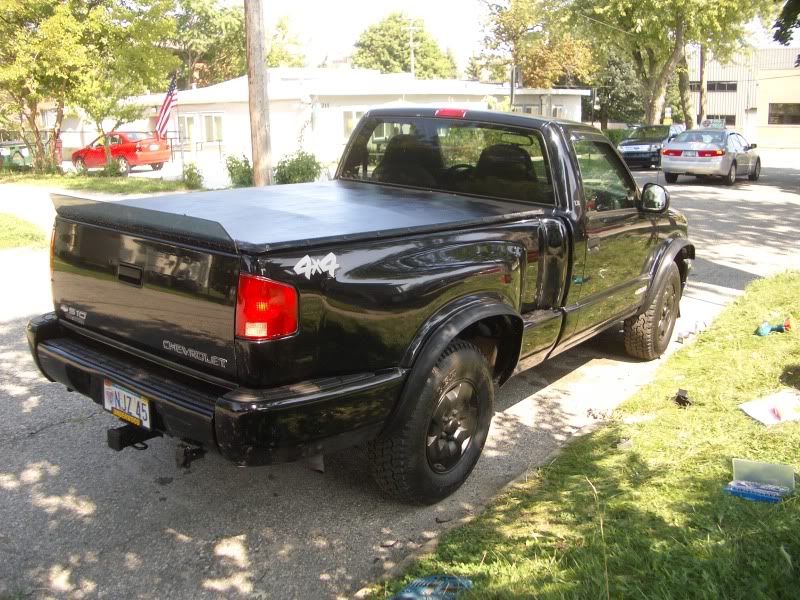

Final; The new look is growing on me. Polishing compound on the new paint, rubbing compound everywhere, cleaner wax, two coats of finish wax.
Work/Play; every truck has to do it, although the hovercraft is pretty light.

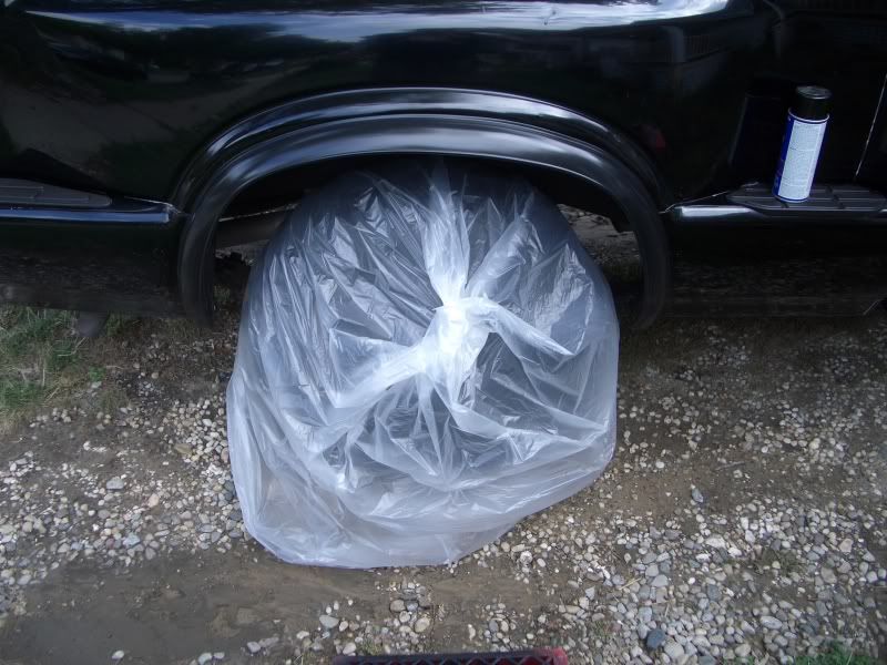

The wheels; were painted satin black. I applied a very generous layer of tire gloss on the rubber and spray painted the wheel (scrape and scuff first of course). I allowed the paint to cure a few weeks before washing the paint off the rubber. This save a lot of time over taping and it comes out better.
Another coat of Permatex rust inhibitor as a final touch behind the new work.

That really looks pretty darn good,George.
The only exception I would make is the blue bow tie. High performance or special editions used red bow ties.

Great job on body work and painting. I know you said it was a fifty foot truck but I wish you would have used a little better flare or left them off. I always thought those generic flares looked like garage door weather stripping that someone screwed on.
The epoxy bubbles are out gassing of the chemical reaction doing repairs in the middle afternoon when temps are stable can often eliminate this as well as prevent amine blush.
Thank you drcoastline, I was thinking that the resin mixture was not fully mixed and it was still curing but the bubbles came back so quickly I was stumped.

Why did you use fiberglass to fix the steel cab in lieu of welding in a patch panel?
Old 10-25-2009, 09:31 AM
Posts: 54,011
My brother is the welder in the family, and I have him tagged for some work on the Porsche already.
I work with epoxy on the hovercraft and used my skills and extra supplies on the S10, because I could.
