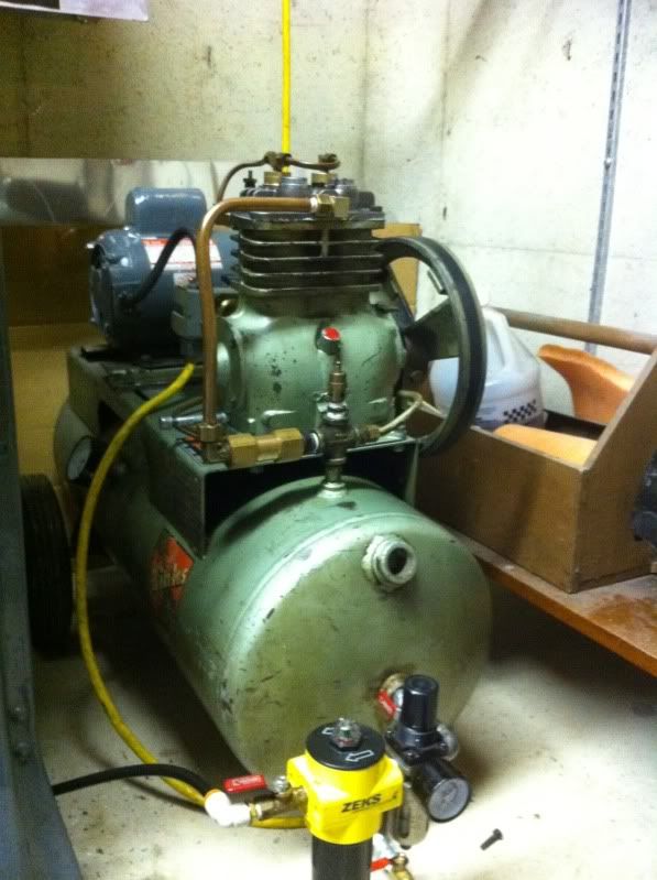

Picked up an old Binks Compressor

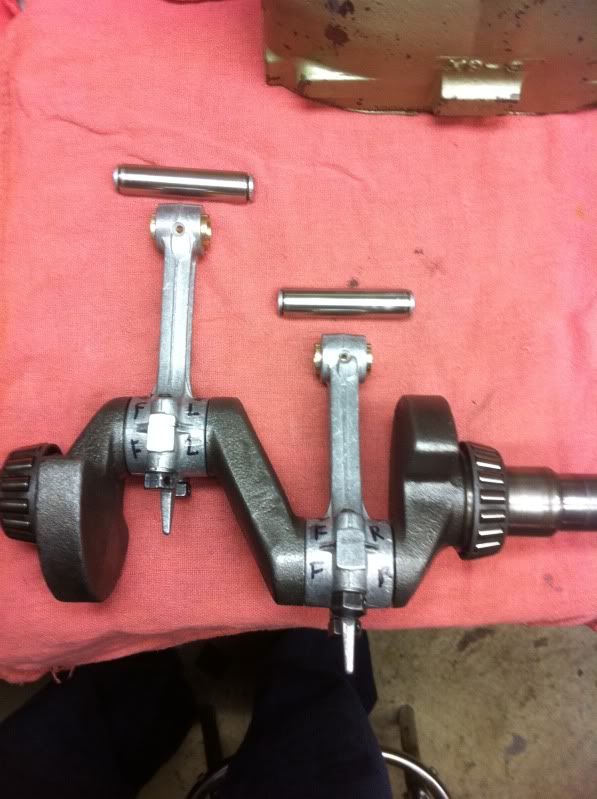

Cheap CL purchase, they sure dont build them like this anymore. Did a little rod resizing/bushing, new wrist pins, polished the crank, cleaned up the head and all is good.

Nice one. WTH are those little bayonets hanging down from the rods?
oil slingers

oil slingers
In lieu of an oil pump

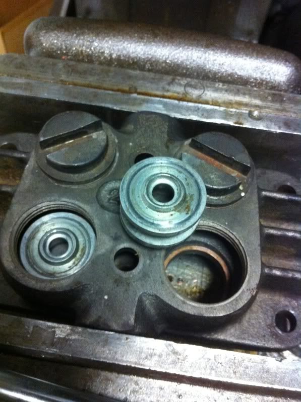

The good and bad is there are no parts for these things anymore so you get them cheap. You have to make your own parts, it had a noisy rod, the wrist pins were shot so you make new ones and bush the rod small end and cut the big end caps down and ream them back to size. The head you can get reeds yet just have to grind the seats.

Bet you are not going to run out of CFM!

Does the motor have a horsepower rating on it?

Its a 1hp motor. I wired it for 220 so my lights don't flicker..

I have the air plumbed into my garage and have an extra 30 gal storage tank up in the rafters of the garage so I should have about 60 gal total storage

1 HP. They would call that 3 or more today. That old rig is very cool.
