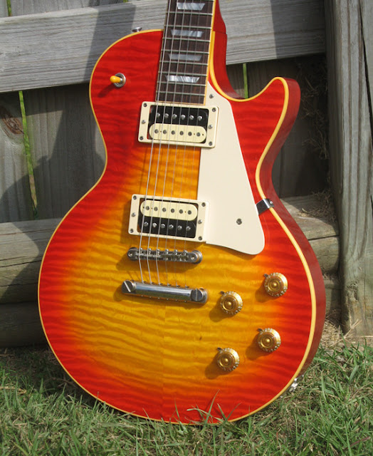

And here's a pic of a completed '59 replica a luthier built for me for inspiration Good wood + Wolf's pickups = awesome guitar
