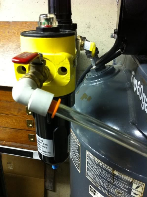

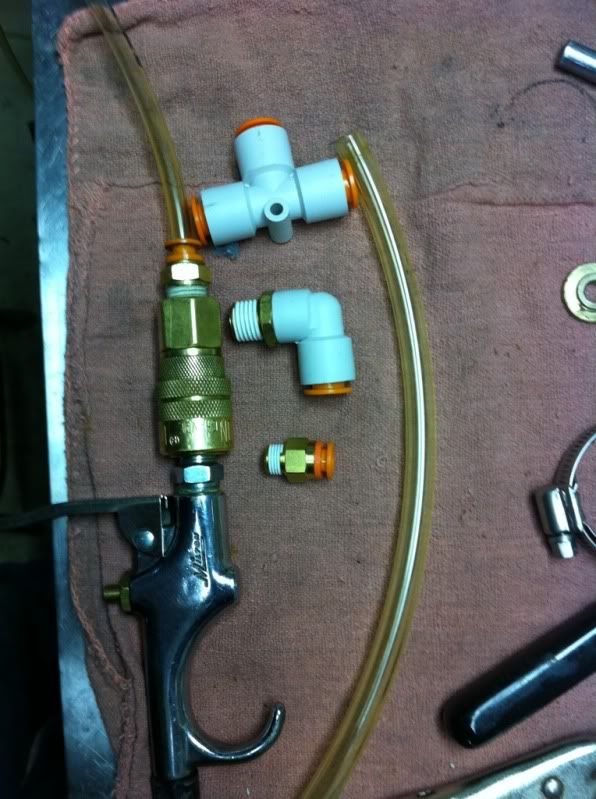

I like the SMC push in connections. You can get them in just about any size and the line you can get in any color. I have this line run all over from my basement to the garage.

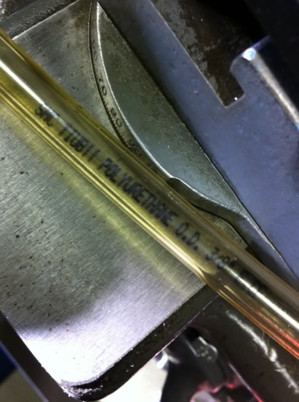

Indeed! if you go with a tubing make sure its either Polyurethane or Nylon Tubing!

[QUOTE=cgarr;5756400]I like the SMC push in connections. You can get them in just about any size and the line you can get in any color. I have this line run all over from my basement to the garage.
[/QUOT/]
How do you get enough air flow during a draw to power tools? Looks like real small I.D. tubing. Looks like vinyl tubing to boot.
The main feed tubing is 3/8 OD and seems to flow more than I use. I have an old 30 gal tank stuffed up in the garage and that feeds my needs closer if I need an impact wrench otherwise all the other tools I have don't require a great flow of air.
The tubing is SMC choice for this type of operation. Its what we have been using in our plant for better than 15 years without any problems.
