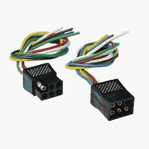

Further searching, the ground pin is broken off.....the left plug (not the actual plug, stock pic off of the net) connects to the trailer. Needs to be fixed obviously....would this be the cause of the non charging of the battery between the tow vehicle and the trailer battery?
I have 12V when I test the pins on the trailer where this plugs into.....

It goes from the square 6 pin to a round six to a LARGE GMC style round six.
The signals, brakes and running light work.....but I think there is an wiring issue for the charging circuit.
This pic is of the side and the next pic is the end, it plugs into
The back of this,
Which has this one the end,
Which plugs into the male GMC plug on my Yukon.

That's actually a 6-pin round going into a 6-pin to 7-pin adapter then plugging into your tow vehicle. IIRC, the 6-pin rectangular is unique to Jayco and I believe it was mounted through a hole in the tougue. With that setup, you should be able to charge your battery. I'd see where the wire from the broken pin leads to on the trailer.

I fixed the ground and plugged it in....got smoke. I should know better, but I was smart enough to fuse it.
Looking at this, Trailer Wiring Diagram For 4 Way, 5 Way, 6 Way and 7 Way circuits it shows some compatibility issues.
The "ground" I fixed was a ground on the trailer but with all the adapters ended up being a 12v connection.....
This thing needs to be re wired or snip the "fixed" lead off and just deal with the no charge issue.

It turns out the round 6 pin is wired incorrectly. I'm swapping wires, will test tomorrow.

Probably but I was able trace all the wires and figure out the problem.
The bottom should read running lights. There is no provision for back up lights and is unused.....
As you can see, the wiring colors are all over the planet. Thanks to my Fluke I was able to figure it all out.
