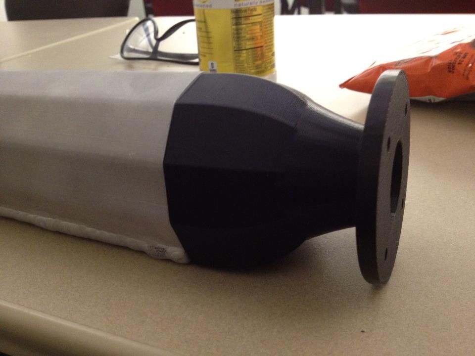

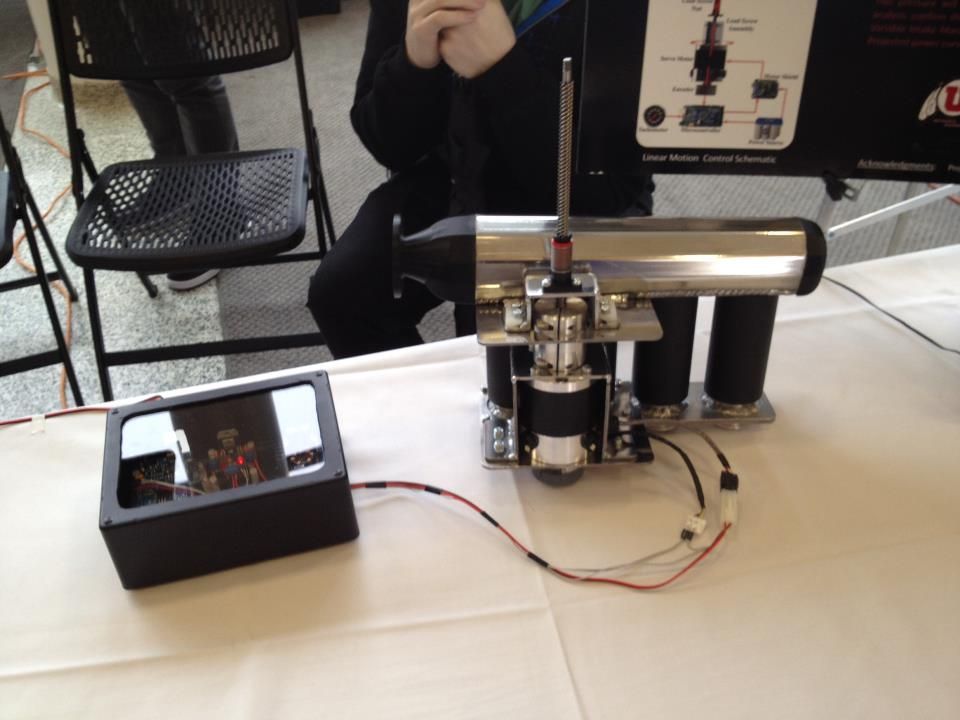

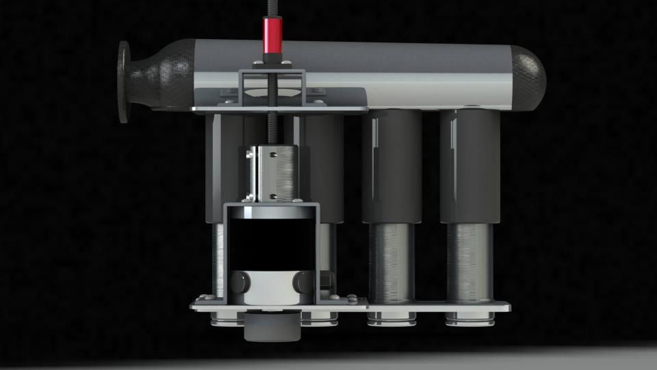

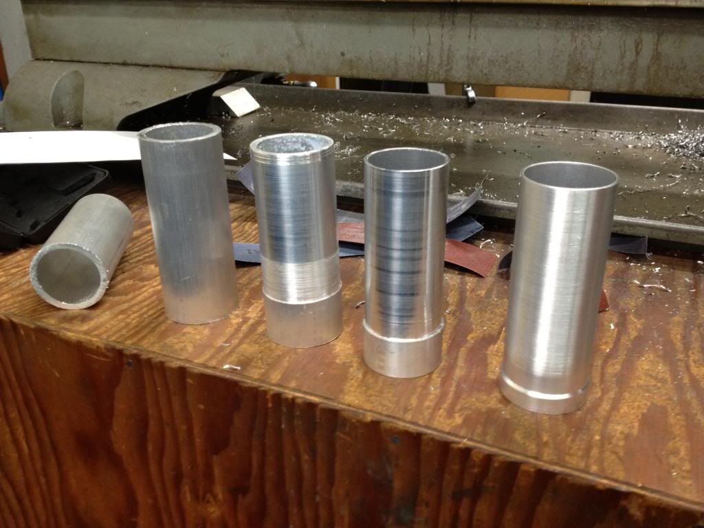

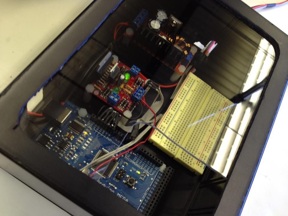

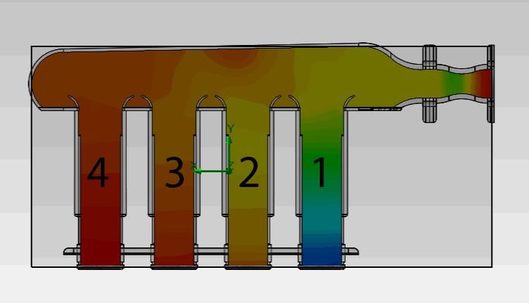

Thread from the dead! I meant to post here when I finished this project nearly a year ago. I thought you would all appreciate it.
We decided on building a Continuously Variable Intake Manifold. The idea was to use the principle of Helmholtz resonance used in most cars for one engine speed, but extend the runners in a telescopic fashion to capture that resonance across the vast majority of the operating range of the engine.
The project was a success! Thanks for all the ideas, everyone. I have a ~60 page write up with ALL of the science,mathematics, and principles on how it works. It also includes build details, materials, analysis, flow specifics, and seemingly endless details. If you are really curious, I can send it to those interested. I'd rather not have it on a public forum, though.
Our greatest challenge was producing 4 continuously telescoping cylinders that would seal up to 5psi gauge (due to natural supercharging effect). We did this with hand machined parts at ridiculous tolerances, and a oil-filled-nylon on aluminum seal. Oil filled nylon has some great properties to naturally lubricate itself while holding a seal. The lead screw assembly was also tricky since the device would have to move so fast on a car.
I'll include some pictures and a video below:
DESIGN AND MODELING
BUILD

FINAL PRODUCT
VIDEO
http://www.youtube.com/watch?v=9daU8hfS3aQ&feature=youtube_gdata_player

Pretty cool.
For post grad work are you going to apply it to an SAE racecar?
Scott
'78 SC mit Sportomatic - Sold
Old 04-22-2013, 03:27 PM
Join Date: Nov 2010
Location: Pasadena, CA
Posts: 179
Pretty cool.
Thanks!
I am actually in graduate school now in California, and the project is left annexed in Utah for now (still under my ownership, though).
It was originally spec'd to work with an '08 Yamaha R6 engine under SAE rules. Unfortunately, the SAE team made a rather large change to their fuel delivery system at the last moment, and we were unable to test our results on the track. If we had some extra money and a couple weeks, it could be refinished to fit on that car, but both time and money had expired on our pretty-much finalized product at that point.

Thanks, everyone!
I would love to adapt it for the 911. I'l just need a few coins for R&D/prototyping/manufacturing costs.
In all honesty, a system like this is VERY difficult to design, and would likely cost a fortune to produce.
I think a dual runner with diverter valve approach is a better one (this is seen in some modern road cars). Regardless, I would be happy to design that for you all, too!
