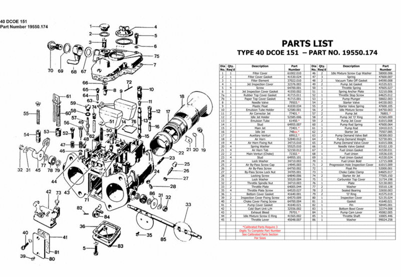

Who knows Weber sidedraft carbs ?
I have a Weber Sidedraft DCOE on my Spitfire project. What is supposed to hold the Venturi's in place? When fully seated the car runs great, but the slightest backfire will make the venturi push out a little then the backfiring really starts....
I thought the O-rings at the insertion point woujld do it, but they don't, unless I have the wrong size o-ring in there.
Does the Air Cleaner do it?
Help is appreciated.

I thought the aux venturis went in behind the venturis, and then a set screw and jam nut locks the aux venturis in place.

that is correct.

Yuppers, had a 50 DCOE on my turbo 914. There's a little set screw thing that holds em in place.
I had one come loose and move once, the car ran great at full throttle but bogged big time at anything else.

You're right, it's the aux venturis I was speaking of. So is it #28 on that blow up? One on either side? Looks easy enough, I just didn't' see it on the underside.
the car will be purring again tomorrow. Thanks guys !

So strangely, my carb does not have the set screw, both holes are plugged on each side. I went back to the original air cleaner base which is more rigid and has a smaller bore for the airflow, which keeps the Oring seal there more secure. Hopefully that will fix it.
