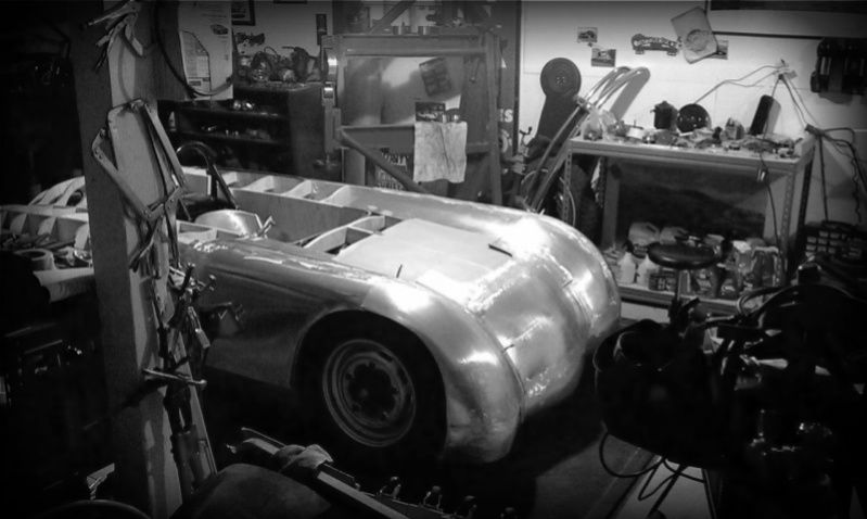

I am impressed with your compound tortured bends !

Thanks afterburn, definitely learning a lot as I go. I shaped the front fenders from the inside to the outer wheel arch. I now learned that shaping from the wheel arch inward is way easier...
I also had an old friend tell me an interesting story about Ferry Porsche. As he was watching the panel beaters and metal shapers he realized that if he assigned right handed workers to the left hand side of a car and left handed workers to the right side of the car the workmen were able complete skinning a car much more efficiently and accurately to the buck. Not sure if it's true about Ferry Porsche, but it started to make sense as I am working on this project. Now I'm trying to be ambidextrous...

Chris,
Thanks for the link to the other site. It answered a basic question about how you will mount the body to the chassis.
When you are done, I'm guessing the body will be two major components with the front 2/3 affixed to bulkheads and structures and the back 1/3 removable for engine access?
Thanks again for sharing this.

Hi Les,
You're on the right track with Bulkhead and structural supports for the body. Similar to the vintage Rometsch cars there are longitudal structural supports with outriggers off of them supporting the body. There will be a bulkhead support forward of the dash and a firewall just behind the drivers seat. The rear end will open similar to the 550 Spyder and will be completely removable as well. All templates are based off of the Buck. The Buck guides all the panels and structural supports. Of course all of this is in my head, no blueprints here.
As of now the front fender/nose clip is going to be removable but I really don't like the seams on top of my fenders... I am thinking to make a removable front trunk/smugglers hole to access the pedal cluster and steering box area.
Here's a recent picture after welding several of the nose seams. It's slowly becoming one piece.

Thanks again for all the compliments everyone. To answer a couple questions...
@MJHANNA- The car will be street legal when done. Although my original intention was to do it for hill climbs, club track days and Bonneville Landspeed Challenge 36hp VW class.
The mid-engine FV chassis that I used was originally bought and registered for the street! One thing I've done with almost all my vintage cars over the past 5 years is take each on a road trip from Minnesota to Florida or reverse order. I've mentioned it to my wife to do it with this car, she didn't say no...
@ZEKE- I've also seen some insane numbers on alloy cars. This is the very reason I'm building this. Not for resale but 1. for the fact that I could never afford a 550 Spyder, RSK or an original Glockler and 2. If I'm going to have an alloy bodied, streamline "special" I wouldn't want a "replica" of one that has already been produced. 3. I've always been fascinated with the 36hp VW Cases and vintage speed upgrades (Read book "Making the Volkswagen Go") 4. I have toyed with the idea of building a couple of cars per year like this to keep in my barn and drive occasionally. I have a really neat sketch of another body design I plan to start next fall. I'm making my contribution to the ultimate barn find of 2060!
Here are a couple more pictures as I work down the car. Most of my seams are now welded and I haven't used any type of filler anywhere. There are several imperfections but I'm slowly working them out... I'm now laying out the rear which will clamshell like the 550 spyder.
