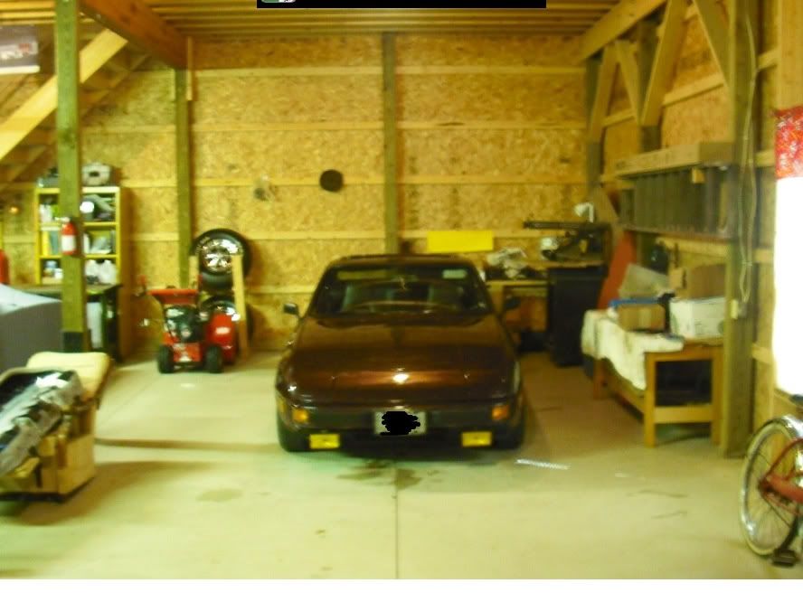

Before my 8' fixtures...
After...
The ceilings are 14', and the fixtures hang by chains about 1' below the ceiling.
