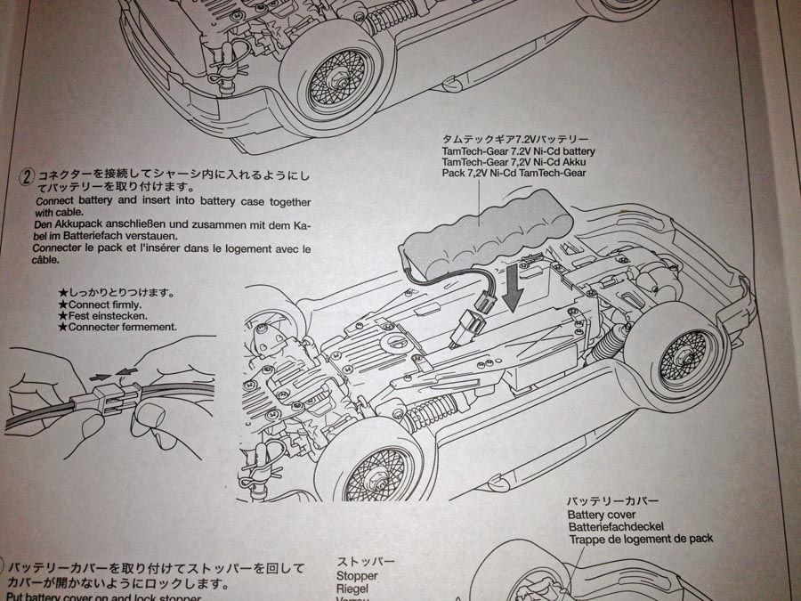

Bought this neat-o Tamiya 1/10 RSR from Japan, batteries not included. It's from 2007, built by the Tamiya factory, was mint in sealed box. BUT, I can't get the specified 7.2V-500mAh battery pack anymore. Many other packs are available though and I am wondering if another 7.2V pack with a higher-amp capacity will work--provided I get one with the correct connector. For example, there is a Tamiya 7.2V-4200mAh on eBay. Will that work?
Yes, I checked for several hours on the 'net already but thought I'd ask the brain trust here before any more searching. TIA!

Higher mah batteries are absolutely no problem if you can find a place to put them. You will get a very long run time but that battery will be much larger physically than a 500 man one. 2007 mean likely nickel metal batteries. 500 man will be approximately as sized and 4 ah will be at least sub c sized cells

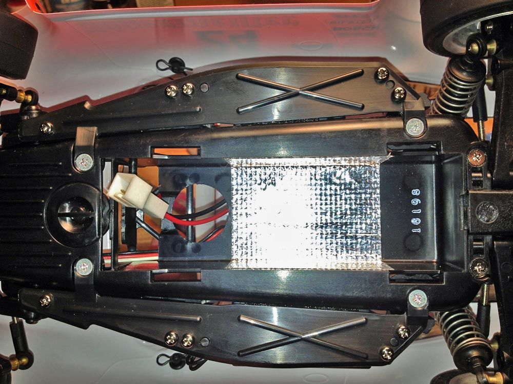

Actually show me a pic of the bat compartment and connector and I'll find you the right battery with 39 seconds of work

Opening is 4 inches by 1 1/4 inches.

Not seeing that exact battery, but there are lots of similar batteries that will fit in that space.

Can use something like this to charge with a connector change
TowerHobbies.com | Traxxas A/C Overnight Wall Charger 1/16 VXL
Battery prob no connector
7.2 volt Elite 1500 2/3A Flat Pack - CheapBatteryPacks.com
Connector set
TowerHobbies.com | Tamiya Battery Connector Set
