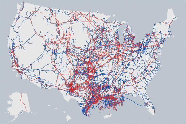

There are lots and lots of pipelines underground in the US.
Here are most of the major ones, but the smaller ones would almost color the map solid.
Personally I wouldn't give it a second thought.
You might not, but around here it's a hit in value. People still remember the Edison explosion in NJ, over 20 years ago.
