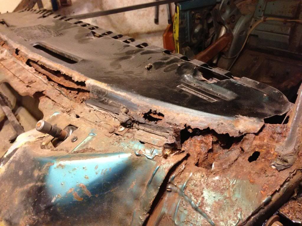

1967 firebird coupe. Where is the rust?
I'm going to look at a coupe with its original 350 and 4 speed manual.
Nicely worn. It's been a driver. Looks good on pictures.
Where do I look for rust? Cheap enough that it will be the deal breaker.

Under the doors, door jambs, lower rear quarters, trunk, rockers, along the trailing edge of the vinyl top, if it has one.

Take a magnet with you. Tap on the areas Lee mentioned. If they feel solid stick a magnet on there and make sure it's not rust that's been patched with bondo!

Floor, the entire bottom edge of the body, plus the rear subframe dogleg.

Area of the frame, and body where the body mounts are. Look good at the area on the rear frame rails where the leaf spring shackles attach . Around the lower section of rear window .

Cowl area can be very bad and hidden under the trim. It is a must inspection area..
Also, quarter panels, floors, trunk - but those are more obvious.

open the trunk. Rear window seal fails and kills trunk. Rear quarters, floorpan. Practically mandatory.

inner rockers, inner fenders, rear valence .....

I've owned three F-body cars in my days (never again!) To the above I'd add the front quarters behind the wheels (and all inner sections behind the wheels where gravel / salt / junk gets kicked up and lodged in there), definitely around the windshield as was posted, lower floor pan (I had one rot out where the e-brake cable penetrates - not fun to fix), pretty much anywhere in the trunk (side areas where it dips down behind the rear wheels for sure), rear quarters seem particularly susceptible as do the lower doors (drain holes are junk and plug up, allowing stuff to sit in there and wreak havoc).

You are all correct. It was a 1967 with its original 326. Looked shiny, looked pretty, ran good.
At close inspection car cancer was evident. She was rusty and crusty.
Most evident areas were around the trunk, inner fenders and floors. Like you described.
I have to say that cowl, firewall picture really scare me. But at that point was no sale for me.
Onto another project.
