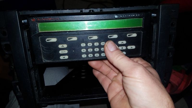

The brain to the system is a Rockford fosgate symmetry epx2, which is a hideaway brain with the control panel which mounts up front. It controls everything from source/ volume, crossover functions, 28 band multi channel eqs.
I'm mounting the control panel to flip up into the dash so it's out of sight, these are very pricey and hard to come by...dont need it stolen

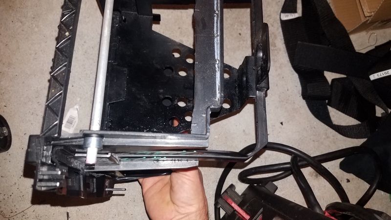

Main hinge for the panel is a 1/4" aluminum rod with bushings, ill be tigging it for the panel mount.
To move it I plan on using a worm gear drive with a ribbed timing belt and pulleys, which will mount on the shaft of the panel flap and motor.
My question is this..... the worm gear motor stops and locks in place, but will the belt system hold the panel stable enough for me to push buttons? They aren't hard buttons to push, but I want it solid.

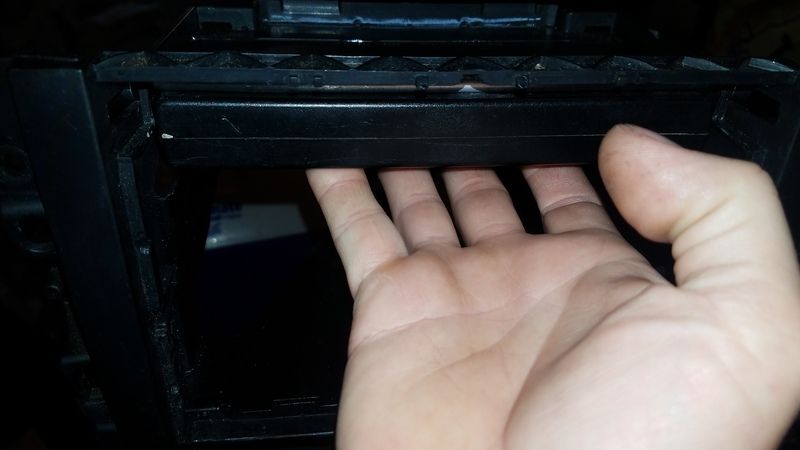

Heres the control panel down in operating position
Here's the panel flipped up in closed position..
A side shot of the aluminum rod mount and where the pulley will mount. Worm gear motor will be down low or behind...

Should be ok with ribbed belt like GT2. Inexpensive, plenty on ebay & amazon, commonly used for plastic printers. make sprockets as large as possible, larger radius and more teeth engaged will be stronger.
Old 12-24-2017, 10:03 AM
one of gods prototypes
bell's Avatar
Location: Orlando florida
Posts: 9,741
Good info.... space wise I'm limited to a 32 tooth at the panel, worm drive is a low ratio so it'll take about 3 seconds to flip down....i think I can play with that too though

That's not a worm gear. Might backdrive, depending on friction and ratio.
Old 12-26-2017, 04:19 PM
bell's Avatar
Posts: 9,741
Got this for 12 bucks at a local electronic surplus place, it's new and they had a test station with torque guage.
It'll work prefect as it has a very short ratio, they didn't have any worm gears that were small.
once I played with this for a bit it'll surely do what I want it to....i can always change it if I'm not happy with it...but I think it'll lock good

If you are worried about button-pushing force overcoming the motor/gear-drive, maybe weld up two small tabs/rails on the inner sides of the console?
That would act as a travel-stop and "brace" for button-mashing when the display is down.

Yes there will be stops for it, and also 2 micro switches to deactivate the motor when it reaches the limit.
