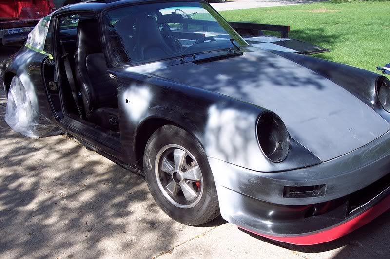

I will tell you what I did. When I repainted my black Carrera the only thing I primed was the spots that had filler, otherwise I just sanded the original paint and shot it.. I used a single stage paint, I don't know if prep would be different with a base and clear?
Painting this Weekend
