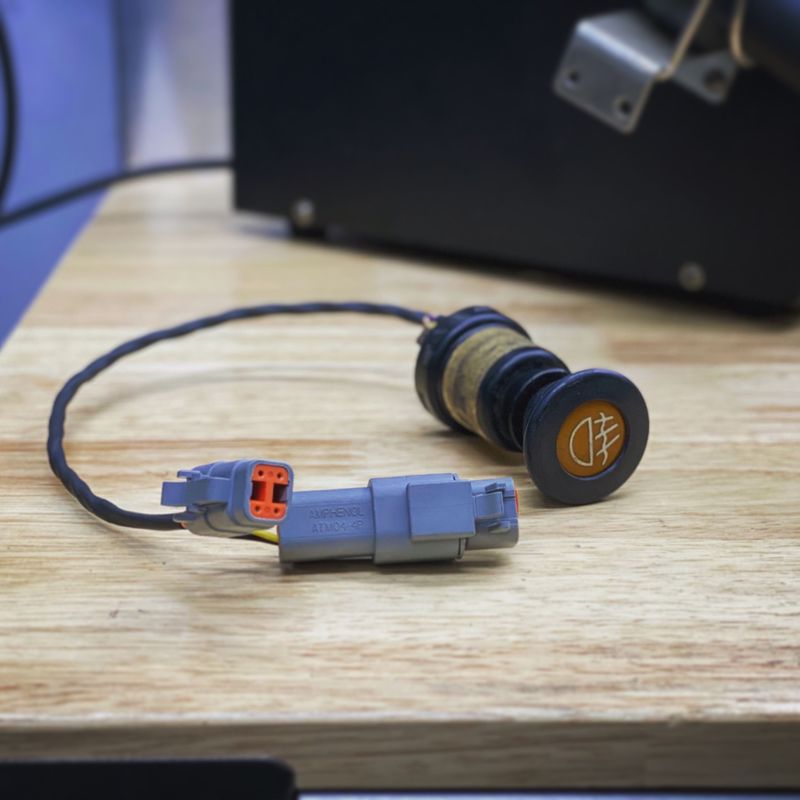

Old 05-19-2020, 11:06 AM
Join Date: Aug 2004
Posts: 996
Intermediate shaft bearings (Genuine Porsche) with WPC Treatment for increased durability and longevity:
Repurposed my no-longer-used fog light switch as a 4 position engine map switch:
Swapped out the stock rods for some Carrillo units:
Just about ready to start putting everything back together
Stock rods with ARP bolts and Canyon one piece pin bushings will be for sale soon as well.
