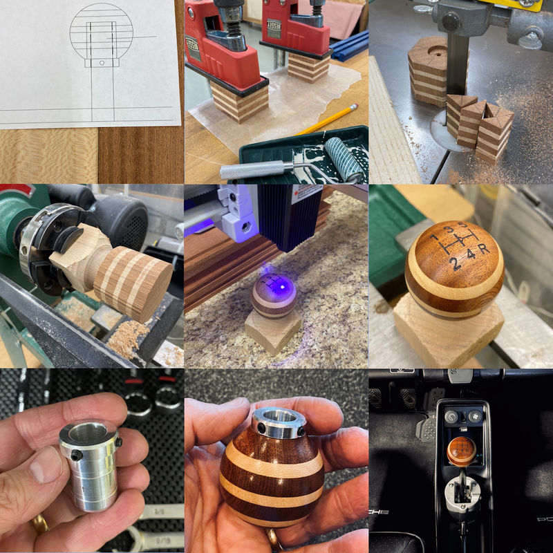

Used up some scraps in the shop to make a 917 inspired shift knob. I kinda like it...
(New shift boot on order...thanks pelican)

Nice work on the shift knob! Any construction pics?

Here's a shot of the process I took. (Metal insert will be black before I install it)
I think the ones you can buy thru the store here on Pelican are a bit nicer, but I wanted to make my own...

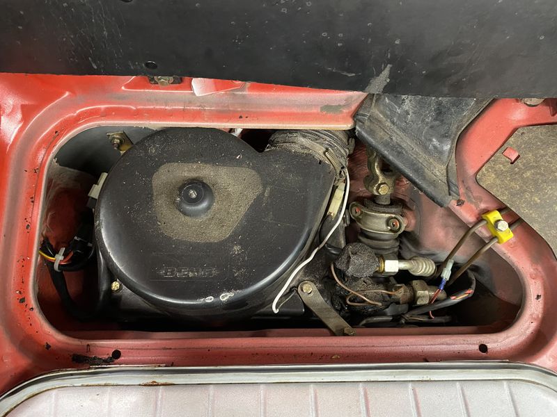

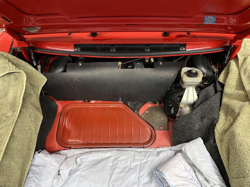

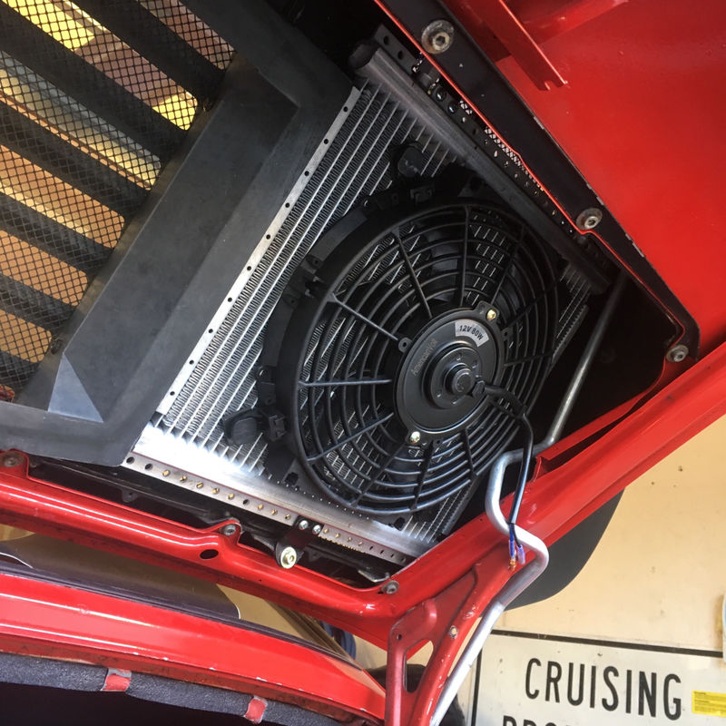

Finally getting started on the Griffiths AC install...
Can’t decide if the person that designed this diabolical thing was insanely clever, or just crazy.
Really impressed with the kit so far. The parts look really good, and the directions are very comprehensive.
My install will go pretty slowly, Lots of little cleanup projects along the way...

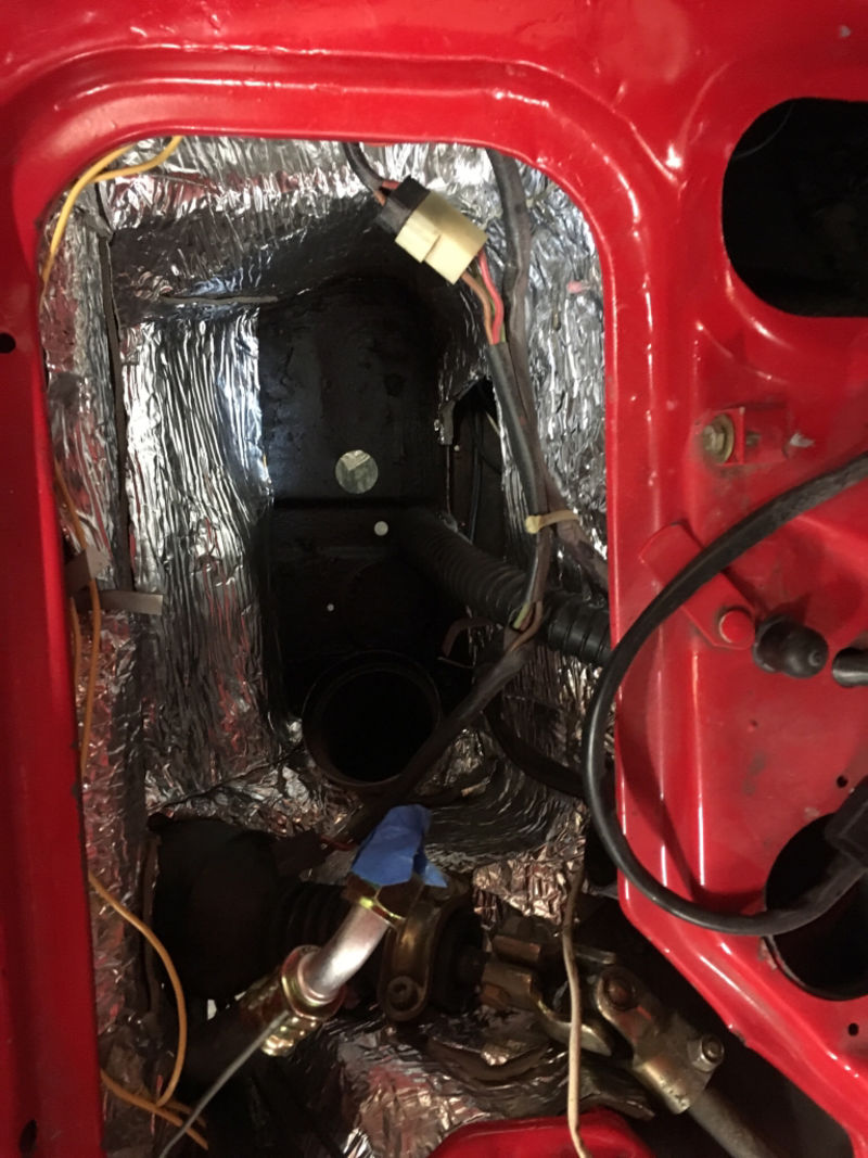

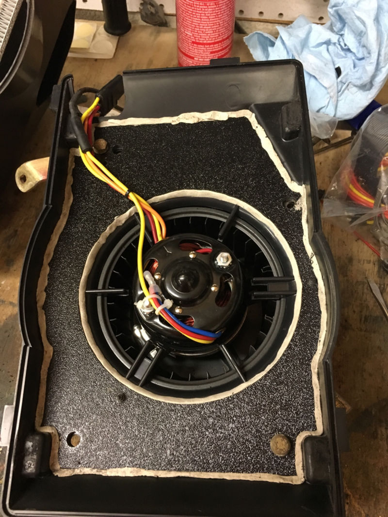

I installed the full AC upgrade kit a couple years ago. RawkneesTurbo was a huge help.
There are a few things you can do to improve the AC system even more.
When you are installing the fan get some strip calk at Home Depot or Lowes and seal the gaps in the plate and fan.
Insulate the inside of the smugglers box. Again HD or Lowes. I got some self adhesive foam with radiant barrier to line the inside with. I didn't do the bottom of the box for fear of moisture setting in the foam and rusting the pan.
Add a fan to the rear condenser. You can use the power wire for the compressor to trigger a relay that turns it on when the compressor is running. A must have for when you get caught in traffic.
Keep posting or PM me if you have any questions.

About halfway through the install, and I continue to be impressed with the quality of the stuff from Griffiths. Really love the variable speed fan control. And the underdash vent that replaces the “bowtie” really looks like it was part of the car to begin with...
We drive this car a lot, so the hose work is just grungy drudge work...heh.
