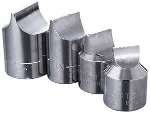

The question is: what tool do I use to tighten this plug? It has a slot in it so maybe a really big screwdriver?

Purchase a "drag link socket".

Impact screw driver with the biggest bit.
You can probably use a big washer and clamp it with a vice grip to turn it.
If all else fail, a pipe wrench.

That goes to the oil pressure safety relief valve. I wouldn't just tighten it. I would remove it and replace the sealing washer. Part number 900.123.071.30.
You could also replace the plug with a later hex-head part so it is easier to snug up.

I don't know what this kind of slotted bolt head is called, but it tends to be a nuisance. The same design, but much larger, is used on the external oil thermostat. Unlike a typical flat screw driver slot, the slot here is curved - deeper in the middle. I believe the intended tool for this fitting is a sort of curved screw driver part to fit a socket wrench, with a cylindrical ring surrounding it and projecting at least as far as the tip of the driver. The ring part slips over the round part of the plug, which keeps the screw driver part from sliding sideways.
I fabricated one of these, but the steel I used for the blade part wasn't suitable for the forces used so I ended up with a pipe wrench (thermostat in my vice and not on car). The drag link socket could be modified, but the "proper" part has a straight sided (but curved end) blade.
The pipe wrench mars the aesthetics but not the function, but using it while the engine is in the car all together doesn't always give you the needed swing room.
The bolt head replacement is a better mousetrap overall. Maybe someone knows why Porsche initially used what they did?

Here is the proper tool, according to Porsche...
A drag link socket is the closest alternative to this.
You can curve the blade, as Walt suggested, for a better fit.
Even if you update the plug to a later version, you'll still need to remove the original one in your photo.
I wouldn't recommend using an impact tool on the plug.

I use an impact driver,,,,not impact wrench,,,,impact driver, with the drag link tool Jon B. mentioned.

Thanks for all the feedback. I can't find a drag link socket on Ebay in the UK but have found this one in the USA that looks like it has been modified to do the job? Is this the one to buy?
