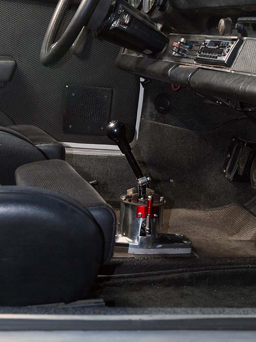

Ok so I recently acquired 2 additional shifters, reason: I don't know really, I like to buy Porsche parts
Anyway, I am wondering what the best setup is for my 77 and what the differences are. So my car came with what I thought was a standard shifter. I have come to find out it has a short shift kit installed. Not sure how different that is from a stock 915 shifter. I see base plates floating around on ebay for the "short shift" kit, but mine does not have that. My only info that it is a short shifter is that it has a welded ring below the shift knob and when I posted a pic someone told me it is a short shifter. I then acquired this one off ebay:
https://www.ebay.com/itm/1974-86-Porsche-911-930-Robotek-915-5-amp-4-spd-Gated-Shifter-Assy-VGC-NR-/113429077999?_trksid=p2047675.l2557&ssPageName=STRK%3AMEBIDX%3AIT&nma=true&si=xJjEf9ftrzCEykpNQf8FFhYyjzU%253D&orig_cvip=true&nordt=true&rt=nc
Not sure what all these parts added to the standard 915 are for and if they actually make the shifter better. This one has an additional shift plate at the bottom.
Then I picked up this one to possibly use parts off of:
https://www.ebay.com/itm/Porsche-911-Carrera-915-Shifter-Assembly-/233037689262?_trksid=p2047675.l2557&ssPageName=STRK%3AMEBIDX%3AIT&nma=true&si=xJjEf9ftrzCEykpNQf8FFhYyjzU%253D&orig_cvip=true&nordt=true&rt=nc
This one look very similar to mine in that it has the welded ring close to the shift knob which leads me to believe it is also a factory short shifter. Are these short shifters better than the stock 915 shifter? Why is there a separate base plate? I can only assume this is to make the shift throw even shorter by raising the shifter up. Is this plate to turn the stock shifter into a short shifter?
I am hoping to install a shifter that rids my car of a rattle when in 3rd and 4th. I have replaced all the bushings in the shift assembly. It seems like the rattle lies within the shifter itself and needs new shims/bushing internally to rid it of the rattle. I can make the rattle go away by putting very light pressure on the knob to the left when in 3rd and 4th. If I stop touching the knob the rattle comes back.
Anyway, any help in the 915 shifter mystery would be helpful.

- regarding the noise in the shifter tower -
There is a tension adjustment on the front of the tower. It consists of a nut locking (22mm) and an allen (6mm) set screw. It controls the tension on the rod cradle. I suspect yours should be tightened up.
Also since the car is a 77, the three throttle rod plastic bushings inside the tunnel could be completely gone. The rod is long, and will vibrate at a certain frequency while driving.

As Bill K (bkreigsr) suggests, the threaded pivot pin in front (late 915 shifter) can be adjusted to remove any excessive clearance at that location. If the 3 bushing areas have also been addressed with no other shifter wear, the noise may be transferring from the gearbox.
The first shifter linked is fitted with a Weltmeister short shift kit. It consists of a different shift lever (longer pivot arm) and spacer block. The shift throw reduction (34%) is greater than the factory M241 short shift kit (20%), but does so, in part, by using an abnormally short shift lever, okay if your sleeve length is at least 36", comfortable with reaching and can tolerate increased shifting effort. This can be remedied with an extended shift lever with a slight loss of throw reduction.

The 915 is finicky and rattly. Short shifters don't seem to help, particularly if the issue isn't the shifter.
I eliminated the 3rd-4th rattle in my setup by replacing a worn solid rear shift coupler with a fresh factory rubber one. The rattle was coming from the shifter, not the tunnel, and it went away with slight pressure on the knob.

Tremelune is bang on...its the entire chain that must be tight,,,from the busing and lubrication, to the coupler. Adding the Seine etc to me is just the next step along with the same extension sherwood shows (which I provided to Seine to also install along with the gate)

So the two things I have to check are the plastic brackets for the rod in the tunnel & my coupler. While I did replace the other 2 bushings I forgot I did not replace the shift coupler bushings as the coupler showed no play when I checked it. I'll replace the bushings/check into the coupler listed above as a fix for the rattle OR just live with it since it's not broken.
Also note, the shifting in my car has never been an issue, just the annoying rattle. Since I don't race my car and just drive it almost every nice day I can, I should be fine with what I have in there now.
