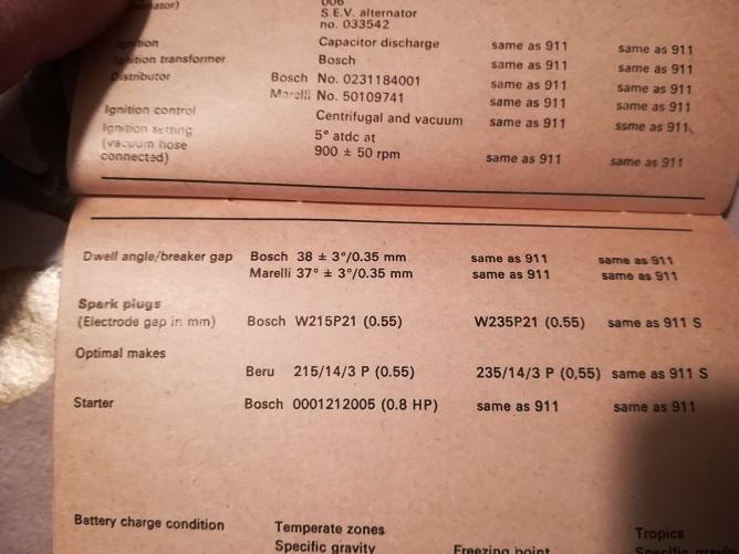

Hello,
I finally (after 11 year of poor usage BTW, 1500 miles only) I changed the spark plugs and the spark plugs wires (BERU, not shielded) on my 911 1974 2700 Erupoean version.
Immediately I noticed low rpm idle speed (400/500 against the usual 900).
I took the car for a spin; the car runs much smoother and reactive than before so apparently the change was made right.
How can it be? Should I just change the idle or it worth to investigate further?

You didn't tell us what spark plugs you used and how they are gapped.
I had similar problems and i discovered that the gap was was out of spec.
Also,
how does the car starts up (cold and warm)... if you feel it difficult to start up it could be a distributor timing problem that has emerged with the spark plugs/cables replacement.

You are right, I didn't mention spark plugs kind and type. I replaced the old ones with the same brand and model (Bosch WR5+).
I have checked just by naked eye comparing the old with new ones's gap with the only purpouse to see the 11 years wearing; then yes I'm going to check it using the proper tool (feeler).
The car starts immediately both cold and warm with no issues at all; distributor cap, points, rotor have been replaced recently and at that time I ckecked the timing but good point to investigate further.

luca..you should not use wr plugs restictors,these plugs should be for Carrera engines. Use wdc plugs..and yes the gap will change your timing as Fiz said..

Getting back to the discussion Proporsche has pointed the suspected problem ... wrong sparks and a fast check to the PET confirm that there are two different part numbers for 1974 spark
plugs.
If I were you i'll try to switch back to old sparks to check and if the problem disappear you know you need 6 new spark plugs!

I installed Bosch WR5DC+ , same as before..I'll double check if they are the right ones and at the same time I'll check the timing

luca ,as i said wrong plugs..................
this is the plugs if not W%DC you should use...

R is just for resistor in the plug. you want copper plugs. the WR5+ is fine.
take a look at how clean the plugs are when you pull them.
did you drive it before you changed the plugs. if you did not then it may not be related to the plugs. if it has been sitting you likely have other issues.
make sure you did not create any air leaks when working on the car.
check your timing but make sure your advance is working like it should. you should see the timing advance as you rev the engine.
if you have any vacuum pots on the dist make sure they are working.
did you change the cap and rotor.
with it idling, push up or pull down on the sensor plate and see if it idles up. you have to remove the air filter.
have you messed with the mixture in the past
