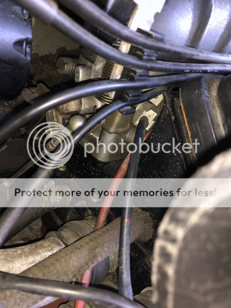

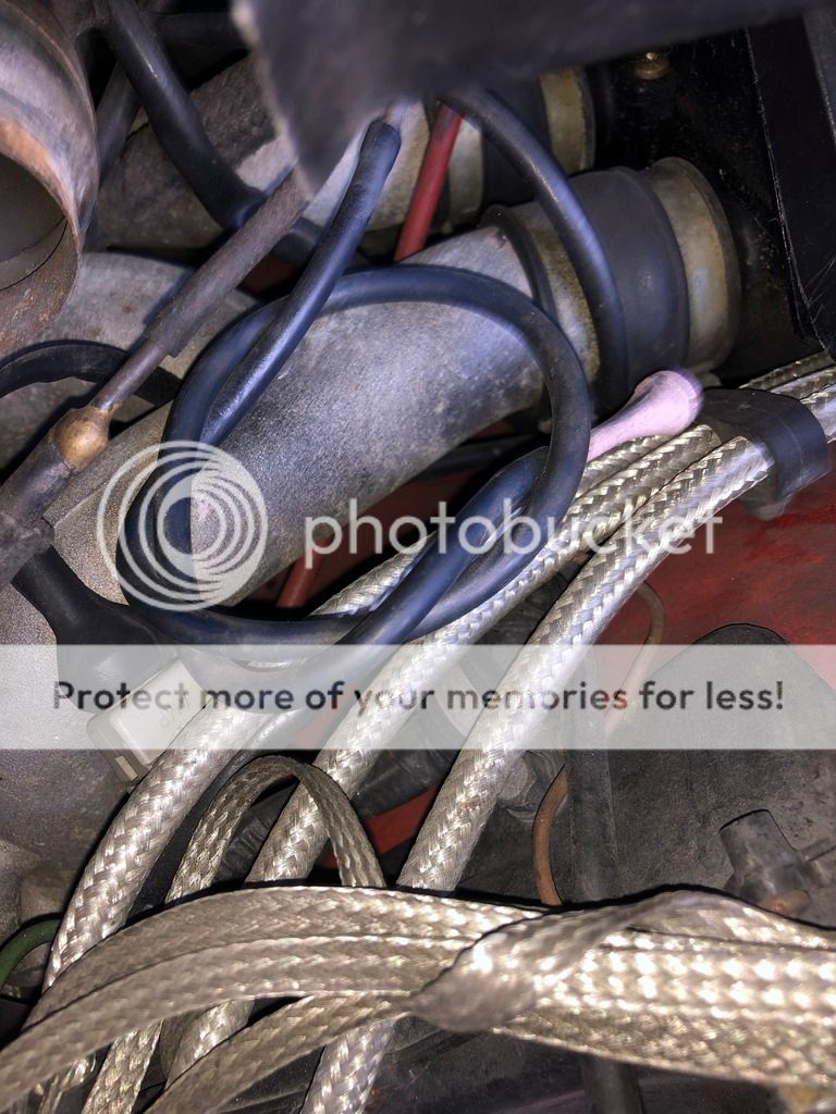

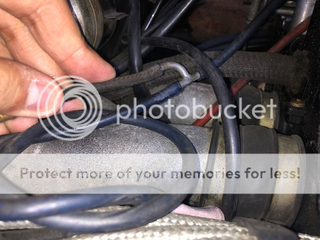

Uploading some pictures of the engine bay:
1) Shows the Vac T Fitting (1 port to throttle body, 1 port to WUR, 1 port to vac cap
2) Shows the vac source from throttle body (Dark Blue line, Red line goes to spark distributor)
3) Shows this hack of a vacuum cap (will be fixing asap)
-1978 Porsche 911SC

Gilbert,
What is this mystery line? Where does the line connect to? Never seen one before and curious to know. Keep us posted. Thanks.
Tony

Originally Posted by boyt911sc View Post
Gilbert,
Tony
Tony, that is sort of some weird brass adapter that goes from the small vacuum line from the T junction to a larger hose to fit over the vacuum port on the top of the WUR.
-Joe

So I can tell you right now that the vac routing that you posted is not what is in my car. Since one of the lines coming off of the T fitting has a freakin golf tee in it, the routing is effectively going directly from the WUR to the throttle body (the dark black vac line I showed) it is on the drivers side of the throttle body. Not sure if that is correct or not - I'm guessing it is not.
So I will go check for a thermovalve and decel valve when I get home and see if the vac routing is just completely borked.
Car ran and drove fine for the last two years until this spring. I'm guessing that it wasnt running at peak but unfortunately I didn't know due to it being my first 911. Ill be happy to get all of this sorted out.
-1978 Porsche 911SC

I believe if you envision the blue line coming off the top of your WUR (ignore the yellow line), the rest of the vacuum routing through TV and DV is accurate.
Correct, except I have a 033 wur so the ports are flipped on part 5 of the diagram. Ill take a look at it when I get home.
