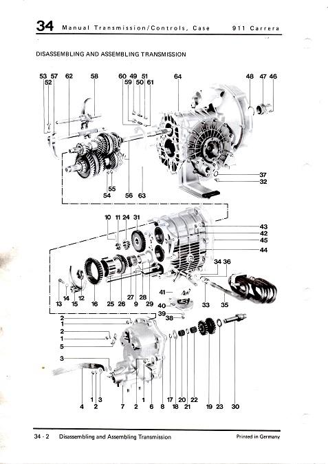

I’m looking to pick up an air-cooled targa and test drove the first candidate this weekend. It was a 77 with a 915 and I was surprised at how awkward and sluggish it was. I realize they’re not known for smoothness, but my ’79 Jeep CJ-7 felt better. The car has 19x,xxx miles and the owner said he just replaced one of the bushings, so is it possible with wear it had degraded to a state that would cause this poor feel? I know there were small changes made throughout the years & models, but I wouldn’t think that would be the reason.

i suspect that car was in need of the shift coupler bushings being replaced. Its extremely common. by that many miles, every 911 will need to have them replaced at least once.
It makes the gear changes feel very sloppy like an old school bus.

There are a few linkage parts and bushings that probably need replacement, and the shift coupler also. It has never been known as a great shifting box, and with 19x,xxx miles, if the transmission has never been gone through, it should be checked and refreshed internally. There are aftermarket shift couplers that can help improve shifting.

The '77 has a mag 915; later ones are alu and got progressively stronger/heavier - but basically the same.
Original box in my car, with 230,000 miles, looked to have been gone through at least 3 times before once taken apart. And it was done. Spun bearings, blued gearsets, non-existent synchros/dog teeth etc.
A rebuilt 915 is a beautiful thing. Lovely to drive. They have an old-school charm but shift nicely. Including into 1st while moving above 10MPH. Although, once you know how much synchos cost to replace, you'll work hard to rev match to avoid wear on those...
A tired 915 does things like won't select 1st when stationary (unless you rock the box through 2nd first, which often helps - as can briefly lifting the clutch slightly and trying again with a different orientation), much less when moving (yeh, that's what dog teeth are for), may baulk at shifting into 2nd from 1st (holding more RPM helped mine here), a 15 count with the clutch down isn't long enough to stop the grinding when selecting reverse, and the shifter feels like a stick in a bucket of rocks...
You can learn to drive around these things and they become second-nature. Then, when the box actually works like it should, it's kind of an eye-opener...
The service life of a 915 between overhauls is generally reckoned to be about 100K - and bill for overhauls has been steadily rising for years, so there's probably a lot out there with some "deferred maintenance".
If you're lucky, it could be just the shift coupler and a few bushings. But with 190K, my money would be on it being time for more than that.

The op has asked if all transs. are the same, not they are no. Some have different ratio and some have limited slip and Euro models have oil cooler on the side.
like this one.............
