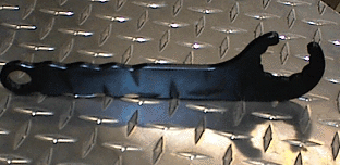

I just ordered # 20 & 33 from our host. I ordered a 36mm box end wrench from Amazon

My mechanic just made me a 36mm wrench. He cut a socket on the lathe then welded it to a handle that he water jet cut for me

Wilding Engineering sent me one of their 36mm wrenches with my engine lift adaptor. Not sure if our host sells them or not, but you can also get them directly from Wilding here. The opening makes it very handy for the oil lines.
How do you get that wrench around an oil line fitting with it installed? And the reverse after you have tightened the fitting? Do you plan on cutting a relief in order to facilitate these things mentioned?
