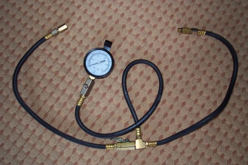

You can measure the FP yourself with a Bosch K-Jetronic Fuel Pressure Tester
The WUR as the name indicates has a warm up phase where the control pressure changes from cold (enrichment) to warm via a heated bimetallic strip mechanism. The mechanic seems to be saying there was no warmup. Same FI system is in many European makes of that era. All Warmup Regulators | SpecialTauto.com
