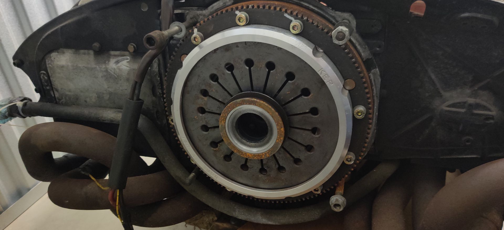

Clutch Question:
The engine I bought is what started out as a 3.2 but now has a 3.6 crank. When shopping clutch components, do I look for 964 stuff? The trans is a G50 from a 3.2 car.
Flywheel?
Slave Cylinder?
I'd like to use 964 RS parts.
1988 911 - 3.6

the 3.6 crank should have the same bolt pattern as the 3.2. So G50 stuff should bolt right up.
If the 964RS clutch bits are the same diameter as the 3.2, then the 964RS clutch bits should work.
IDK anything about the slave cylinders.

Thanks, I don't want to start buying stuff and find out the hard way it's not gonna work. My guess is, I should be safe with what ever part is stock for any 88 911 for the slave cylinder. Right now the engine has 915 stuff bolted to it.

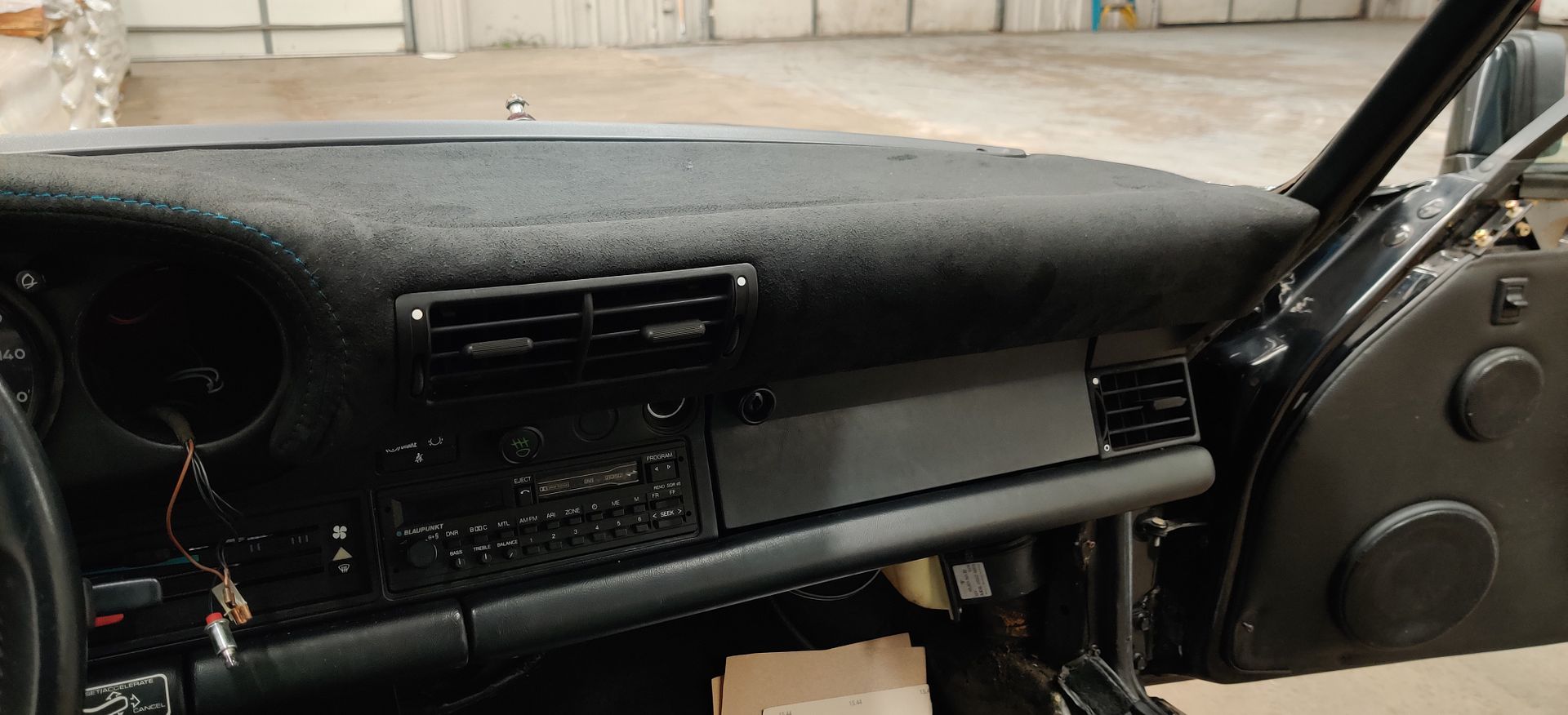

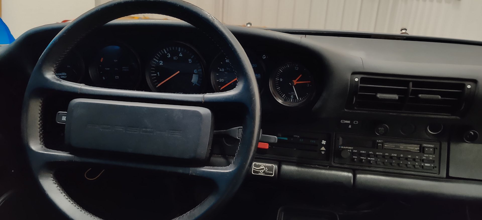

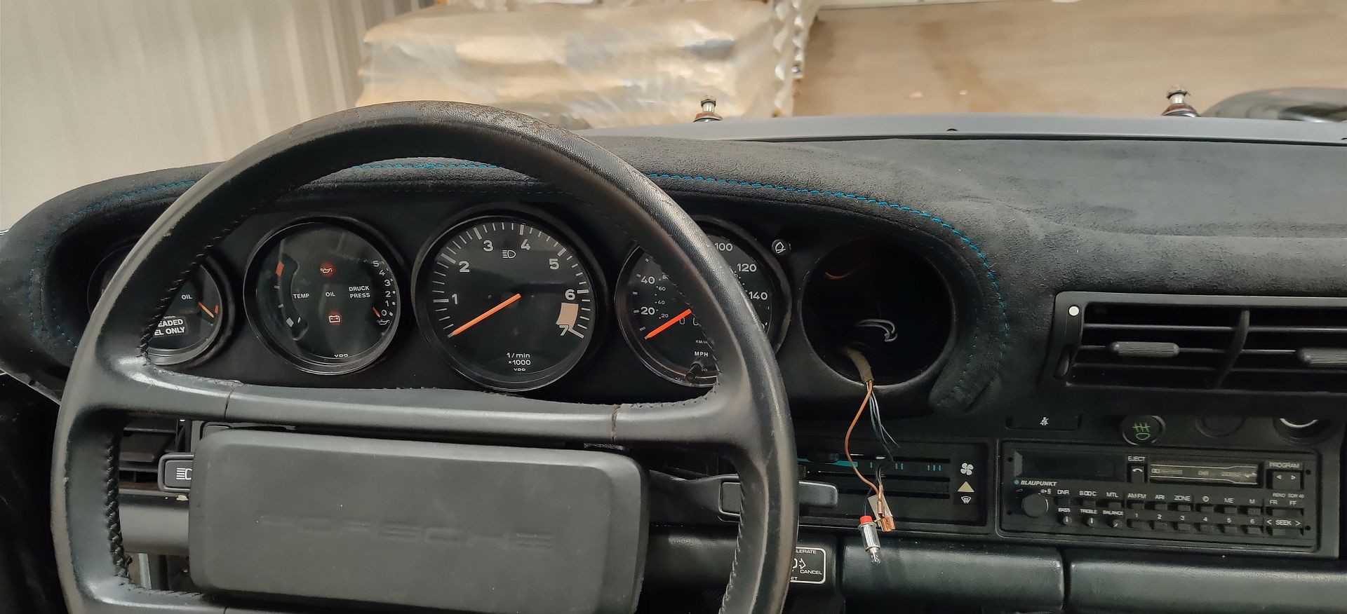

Got the dash board back from the upholstery shop and back in the car, not 100% satisfied but I'll live with it. I had the door card tops and trim pieces below the rear side windows done to match. Next stop at some point is Olsen Motorsports in Downer Grove IL for a headliner and glass reinstall. About the only thing this car will be in a shop for. Once I sell my M3, the pace should pick up. I doubt It will be done by Spring though.
Before:
Now:
Before:
Now:
I’m excited to see how this car is going to turn out! That dashboard looks amazing! Never seen one with Alcantara/suede but I love it now! Tim @ Olsen Motorsports will definitely take care of you. I just had my calipers rebuilt & re-plated with them and they turned out great! Hope to see you driving around in spring!
