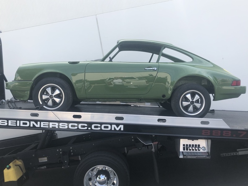

1974 Olive Green Porsche build . Should I keep the trim chrome(or whatever the factory called it) or powder coat it black? My wheel choice of course will be dependent on the color of my trim.
What do you all think? Personally it would be easier to keep it chrome but figure while the car is apart now is the time to make the change. The last picture of the Ruf 993 was the original motivations. Thanks,

I was going to say chrome... then I saw the Ruf- man, that black looks good on it, but your car is older, so chrome may be the best look.
Yup, I’m of no help! Love the color though

Thanks guys.... amazing that everyone says keep it Bright. Living in So. Cal the group I roll with all thinks Black... so confused now.... Maybe should have mentioned it will be a "Hot Rod"...

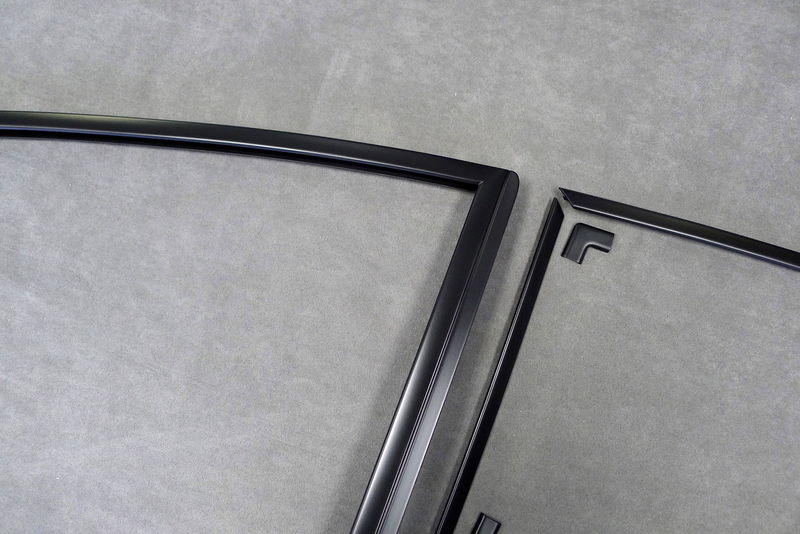

If you go black, don't use powder, use Cerakote. Powder is thick and ugly. Whoever does the Cerakote, make sure they do 3 coats/bake cycles for both finish and lifetime durability.
Bright is just anodized aluminum. If your car came with painted frames, chances are good they can't be anodized, at some point Porsche switched to a cheaper, porous alumium that doesn't anodize (aesthetically) well. They do have a slight different profile so easy to tell the difference between the two.
Satin black Cerakote
