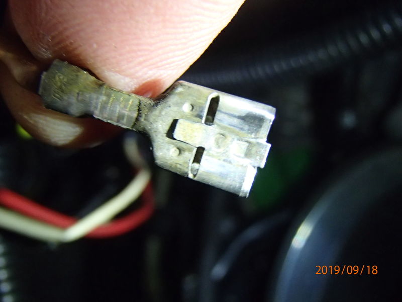

Brown ground wire on top in photo is dislodged from connector and not making contact. That will mess up the regulation.
There is a small locking tab on the terminal that you can lift away from being parallel to the blade so it will latch upon insertion.
Pull it out, fix it up and push it back in until it latches.

I did not see that loose ground wire when I changed out the VR. I did see it in the pics when I posted them here but thought it would still make contact. I have since looked and it would have been a poor contact at best. The locking tab was pretty flat to the rest of the connector.
1 - I pulled the ground connector all the way out of the housing and polished it up with the dremel.
2 - bent the locking tab up and reinserted. It clicked in.
So, the question is, when did the connector become loose in the housing (or whatever you call it)? After I unplugged the VR I had been running? or before when I was messing in the distributor area? Or even earlier when I installed the new CDI wiring from Timmy2, which was several drives ago.

Small screwdriver in the small hole below the flat of the terminal. Insert about 1/8th of an inch and gently twist back and forth while lightly pushing and pulling the wire in and out.
The plastic connector body is likely fine as long as the tabs lock in place. It is just for alignment.

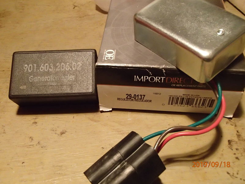

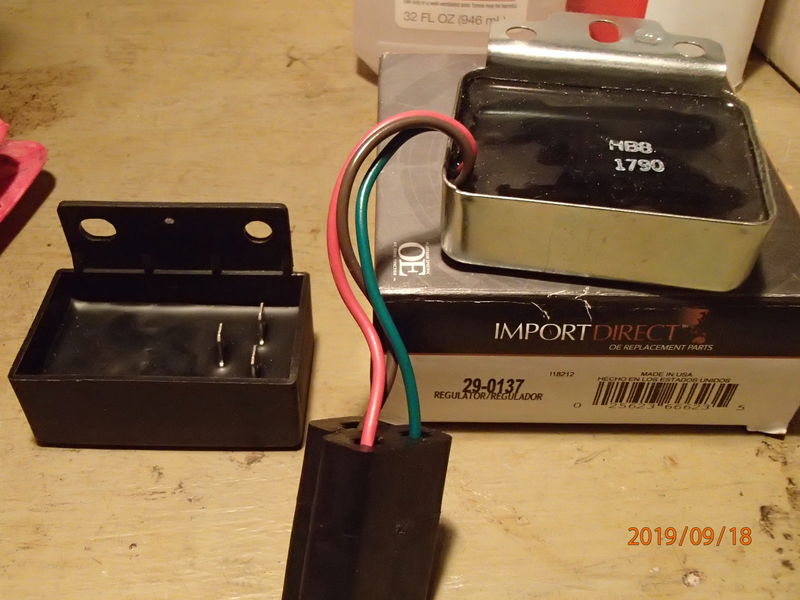

Let the car idle in the garage for 5 minutes and the voltage was a constant 13.5 volts. 15 mile test run, and all ok (the voltage reads lower with headlights on, but that is what it has always done, 12.8v at the cigarette lighter).
Pics below. The VR I am running now is the shiny metal one I got from the local Irish auto parts store. I also show the connector that got loose, pulled out. I had polished it up before this photo, but had not bent the tab out yet.
I am not sure what VR I am going to run with long term. I should test out the VR (black plastic one in pic) that was installed before this problem occurred. We will see if I get that done.
Thanks for all the help guys, and if anyone has a recommendation for a VR, let me/us know.
