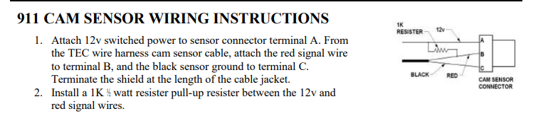

Hi All,
I am running a 3.2L with AEM Infinity 6 in semi sequential mode. I have installed the Clewett Cam sync sensor per instructions, but could never get the signal to be consistent enough to reliably run in sequential mode.
I was reading the instructions carefully again and noticed the requirement for a 1K 1/2 watt pull up resistor in the wiring between the 12v+ and signal
wire.
The infinity has a 10K pullup to 12V on pin C1-26 (Camshaft Position Sensor 1 Hall) but I was wondering if I need that 1K 1/2 watt pullup ?
Hoping anyone who has run this combination successfully can answer as I'm planning my list of winter improvements. Also, did you have to make any noise value adjustments in the wizard from the standard 10 / 10 settings ?
Thanks
Sandeep

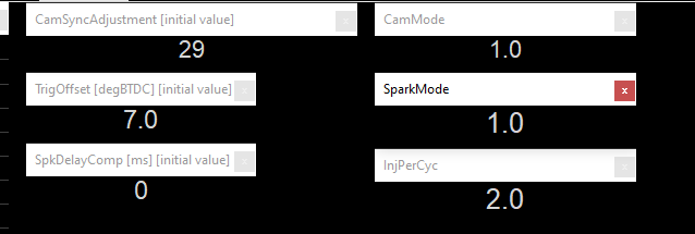

Using a rothsport 36-1 trigger wheel and sensor with CSA value = 29 and trigger offset = 7. 29 x 10 degrees per tooth + 7 = 297.
Let me know if you need any info ... car runs awesome for me. This setup was for semi sequential operation ... I'm now trying to get the system running sequential so those #'s may change.

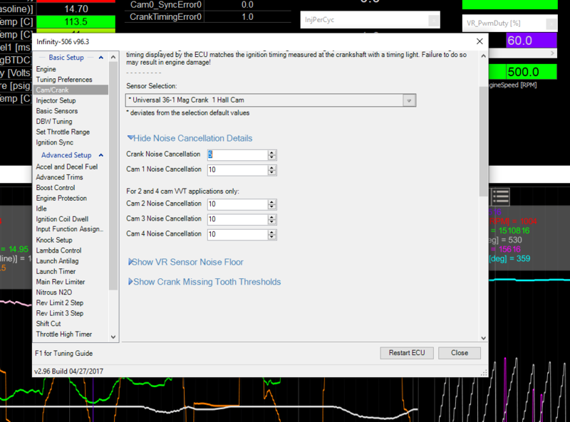

Due to the COVID19 19 Pandemic, I am stuck at home with nothing to do but try and get this cam sync issue working.
I ripped out the existing crank VR and hall cam wiring and rewired properly with twisted/shielded cable like the piece that shipped with my Infinity mini harness (DIY).
Looked at AEM wiring diagrams and terminated the wiring properly with the shield drain to ECU ground, and got rid of that resistor as shown in the original diagram from Clewitt ... maybe that resistor had something to do with the TEC brand of ECU's ?
Loaded up the sequential firmware, started and still have the same problem
Can someone share their noise cancellation values from the diagnostic tab of the software ? The car starts and idles on sequential but I am now getting crank timing errors ?? I reloaded the semi sequential firmware and unplugged the cam sensor and all is fine again. ??
I am hoping it is a noise cancellation value in the software so looking for guidance from someone who is running a VR crank and Hall Cam sensor.
Thanks
Sandeep

Since the ECU already has a pullup resistor on the signal wire, the external pullup is not required. I have seen issues in the past with the bolt used for the sensor to trigger off of being non-ferrous and causing sync issues.

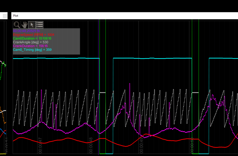

Would that bolt cause the issue in the screenshot below ? The car does start and run, but I keep getting these crank sync errors now which were not present when I was running semi seq firmware ?

some parameters along with the log shot above.

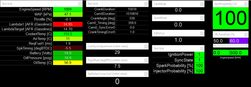

Diagnostic page from wizard
1966 912 Turbo - Carrera 3.2L - GT3076R - Bosch 044 - Intercooled - 55lb injectors - 0.5 Bar - Tial F46 - Magnesium 915 7:31 - BBS E26 15x9, 15x10 - Link G4X Fury

Noise cancellation values

I am successfully running the Clewitt cam sensor on the Infinity in sequential mode. Here is my setup.
1. I did not add a resistor.
2. The locktite does not affect the reading of the sensor.
3. I did not touch the values you are showing in the software. All of my values for sync error are like yours. My values for noise cancellation are also like yours except the one you have highlighted that has a value of 5. I have 10.
4. When I was setting up my car I had the + and - vr backwards and could not get my car to start.

Thank you for the continued feedback. I put the timing light on the engine again to verify my crank settings and trigger offset for the 36-1 wheel and its bang on.
I noticed another issue, not sure if its relevant or not ?? I cannot get the car to idle for longer than about 200 seconds of after start time after the first start of the day. For the second start, the battery is too weak and needs to be boosted ? Perhaps time for a new battery. Hoping it's not the issue though.
Edit ... car continously stalls now after each crank error.
