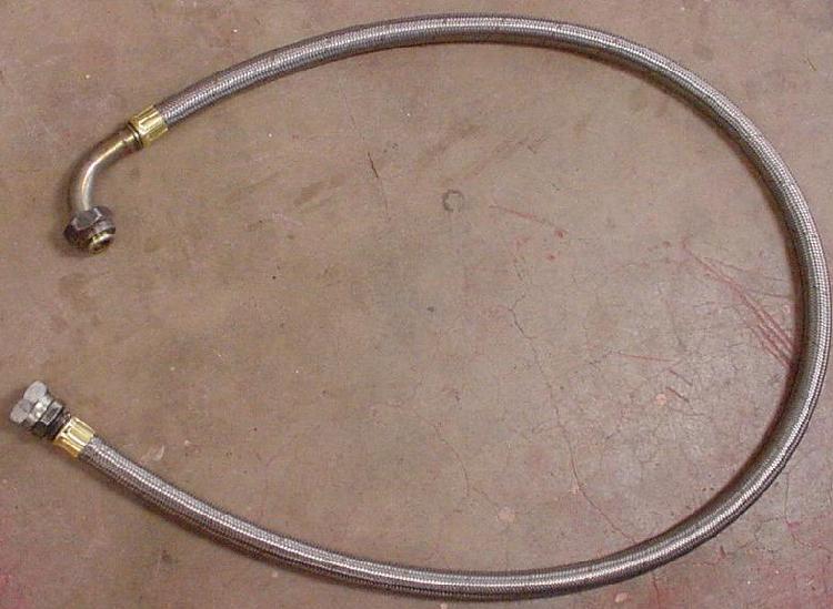

I have this oil line, which I got with my B&B headers but didn't use. It goes all the way from the case to the thermostat. I'm told these are sold for doing exhause conversions. Make offer - I had new hose put on it back in October, it's been sitting in a box ever since:
http://forums.pelicanparts.com/attachment.php?postid=567118

Thanks guys. Thom, I PM'd you about the line. Also, which shop swaged on the hose for you?

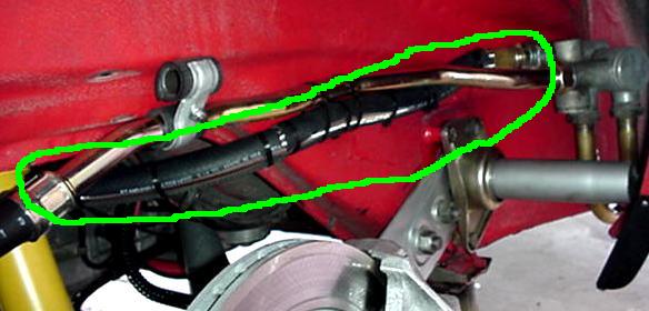

The line I have for the B&B headers is not as long as Super describes, so it must run under the motor case and up past the heat exchanger tubes.
I cut some coolant hose to fit around the flexline so as to have something for the zip strips to grab onto. Looks kinda like a rig job to me and that's one of the things I don't like about the B&B headers. If I could use the backdated/SSI oil lines for the B&B headers I would be much happier. Anybody know if this is possible?
Yes. That is exactly what I did on my 3.6 in my SC.

Would you happen to have a picture Paul? Just curious to see how the lines run around the B&B heater boxes, tubes and into the front oil cooler thermostat.
