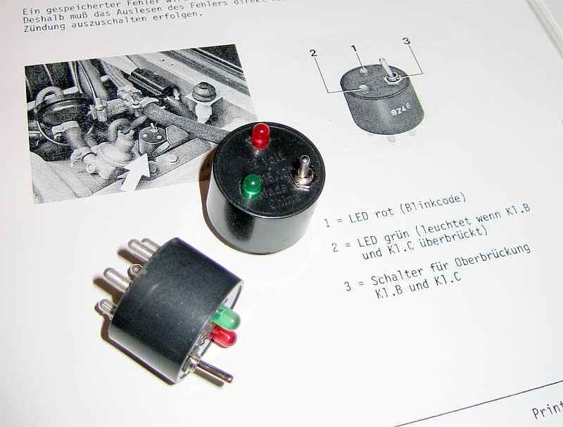

Empty engine fuse panel slot
Probably has been asked before but what is this empty socket for on the engine bay fuse relay panel?

this female plugs is for adjusting idle tool, like this one i have.
Some people use isolated single wire ....
Ivan
here is the tool number....
or you can make yourself ,one like this one on the bottom left..from the original

Wow! An 80s diagnostic and adjustment capability. Cool. I’m not sure but some of the info you mention in your post did not come through. Thanks!

Now I see them! Thanks again!! Pretty slick little tool! I’m sure if I had one to go in the tool kit (I don’t have!) it would raise the value of my PCar precipitously��

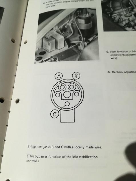

Schematic?

this might help?

I like the micro switch and red and green lights! Love when there are lights.
